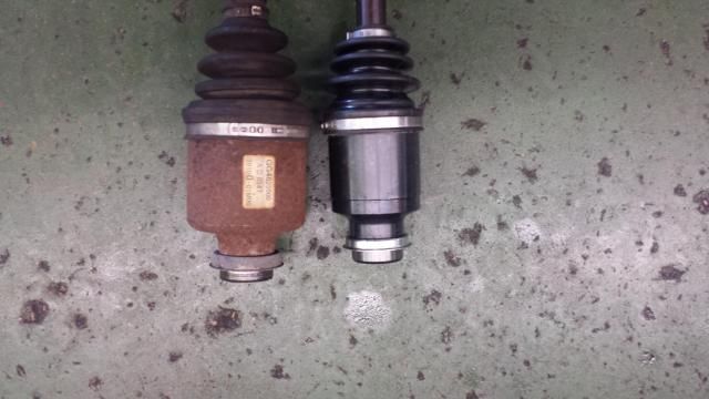

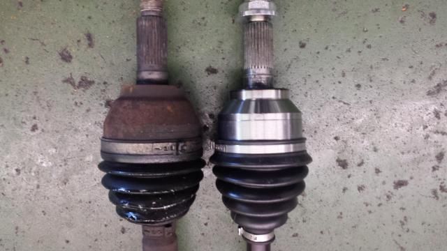

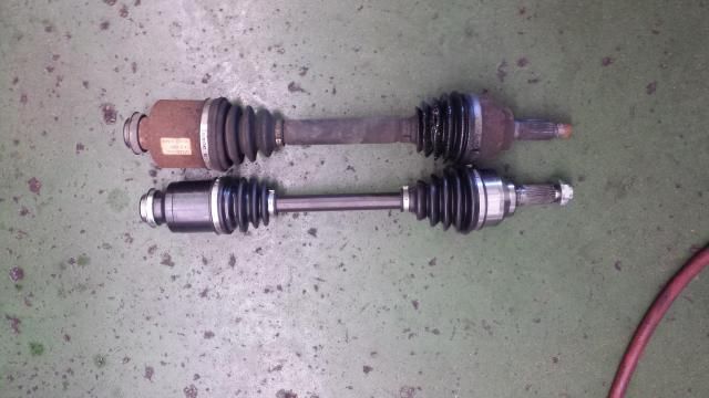

I ordered these last week and went to install my passenger one on monday and I dont know if anyone else who has these can report the same findings or not, but the dta axles are definately smaller, and lighter than oem. Not sure if they are made of a better quality material possibly? But they appear the same size as whats on my 05 mz3
http://i266.photobucket.com/albums/i...ps2854feb4.jpg
http://i266.photobucket.com/albums/i...ps592021ae.jpg
http://i266.photobucket.com/albums/i...psfe2bd22f.jpg
I did install it, and at this point can not say there are any issues with it, other than possible longevity since its not as beefy. But if those who have had these for a year or longer can attest to them being smaller like this and havent seen a failure that would set my mind at ease
mituc 10-22-2014 11:07 PM
I don't see any problem with them being not as beefy as one manufacturer can use higher quality materials especially in low volume parts, but I do with them being shorter. Maybe you've got the MS6 axle?
As for gen1 vs. gen2, they have the same tranny and diff and the only thing that was concerning was the distange between the diff and wheel hub, so if the axle length was good on one side most probably is good on the other.
celery952 10-23-2014 06:59 AM
I dont believe its shorter, I think the cv boots are just more relaxed with 170k miles on them. that inner boot on the old one is stretched out from being pulled out on when still bolted into the spindle

mini necro on this thread;
so my cv boot shit the bed a couple of weeks ago, and after going back and forth with trying to fix the boot, I said fuck it, and removed the whole axle (drivers side). I will say this, after being an idiot and trying to take a shortcut by fixing the boot only, I realized I should've just listened to what I read many times on almost all threads I found: fuck fixing the boot, just replace the axle (in case any one else googles this).
anyways, back to the point. I went ahead and ordered the axle from the link provided on post #1 , and went to town on my pu. Everything went smoothly. axle went right in, everything buttoned up nicely, and I took it for a test drive. so far I've put about 120 miles on, and no clicking or clunking. this was installed on a genpu speed.
here are some pics for comparison between the stock axle and the DTA one. the DTA axle is the one with the plastic underneath it. I am no materials expert, but it looks like the boots are made from a different material on the DTA axle. The stock boot is pretty fucking hard, this one seems a little flimsier than the stock. Not knocking it down by any means, it's been solid so far. Hopefully it will last a while.
tldr; axle fits in pu, has been solid so far.
