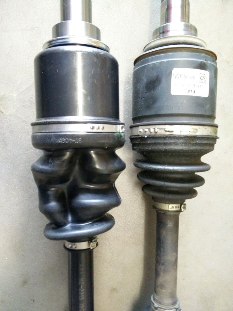

ryguy 3 05-23-2016 10:30 PM
Originally Posted by celery952 (Post 2733105)
I ordered these last week and went to install my passenger one on monday and I dont know if anyone else who has these can report the same findings or not, but the dta axles are definately smaller, and lighter than oem. Not sure if they are made of a better quality material possibly? But they appear the same size as whats on my 05 mz3
http://i266.photobucket.com/albums/i...ps2854feb4.jpg
http://i266.photobucket.com/albums/i...ps592021ae.jpg
http://i266.photobucket.com/albums/i...psfe2bd22f.jpg
I did install it, and at this point can not say there are any issues with it, other than possible longevity since its not as beefy. But if those who have had these for a year or longer can attest to them being smaller like this and havent seen a failure that would set my mind at ease
Can anyone confirm if the DTA axles are really that much smaller than the oem axles?
