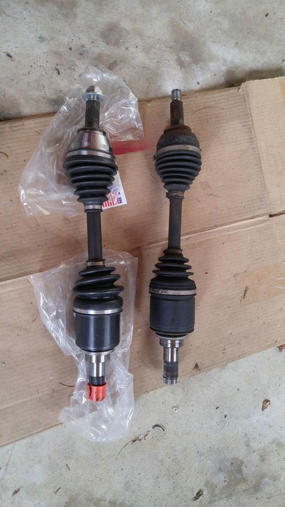

I can't confirm the passenger side, but the driver side was identical. Here's a side-by-side.
The axle held up for track day #1 with no issues. I'm going to try to re-build the OEM so I have a backup (and for shits and giggles).
As John found out, the only issue noted so far is that the inner joint is only held together by the boot. I take care when installing so you don't have that joint fall apart.

Yeah, you literally need to bungee cord or strap the hub to the LCA while putting the strut and everything back together, just an FYI. The inner joint comes apart super easily.
Like ChaunceyM I have had zero issues with mine so far otherwise. When I had mine side-by-side, they were identical length.

Was the oem inner joint only held together by the boot?

Probably because these axles are cheap as fuck.
ChaunceyM 05-25-2016 07:24 AM
No, the OEM inner joint is held together quiet firmly. I just yanked on the axle itself to pop it out of the tranny.
I've never done an axle swap before, but from what I've read/heard, that is not always the case. Often they are only held together by the boot as there is not supposed to be any strain applied in that direction. Only to get it out of the tranny.
