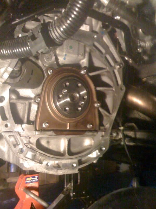

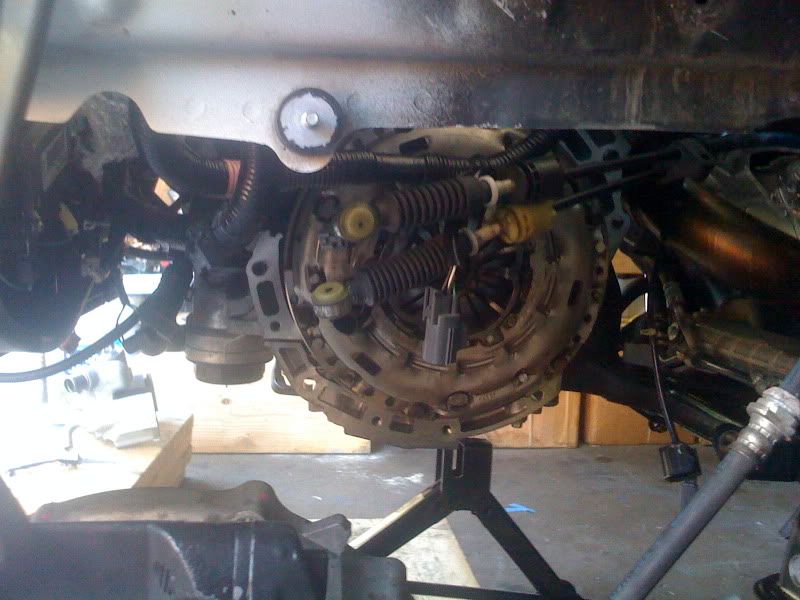

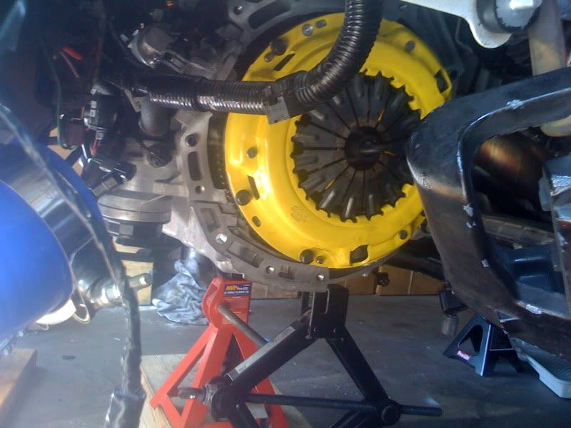

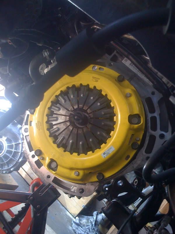

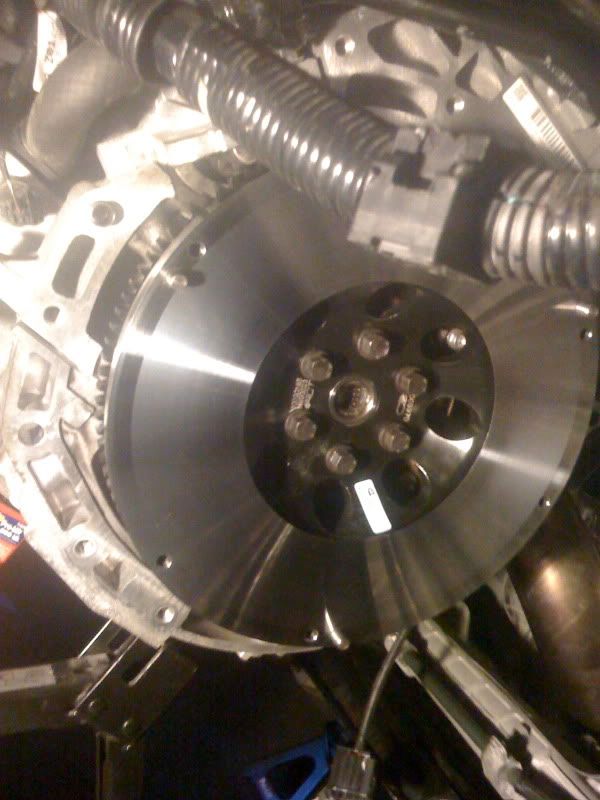

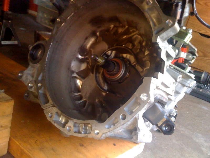

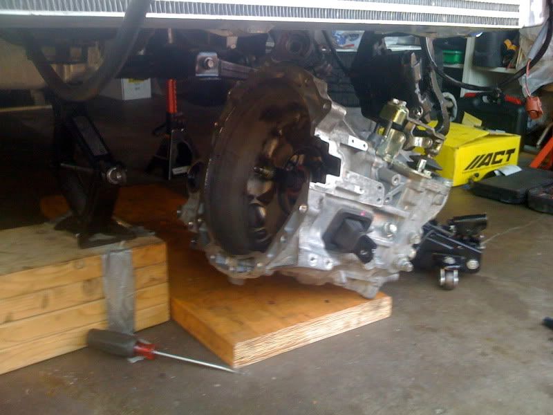

trickytwelveinch 07-02-2009 01:18 AM
ACT Clutch/Flywheel Installation w/ pics
Alright biothces here the pics:
http://i141.photobucket.com/albums/r...s/IMG_0893.jpg
http://i141.photobucket.com/albums/r...s/IMG_0894.jpg
http://i141.photobucket.com/albums/r...s/IMG_0895.jpg
This is the stocker
http://i141.photobucket.com/albums/r...s/IMG_0891.jpg
http://i141.photobucket.com/albums/r...s/IMG_0898.jpg
http://i141.photobucket.com/albums/r...s/IMG_0900.jpg
http://i141.photobucket.com/albums/r...s/IMG_0901.jpg
Well, I must say the install was a breeze- didn't run into any issues aside from accidentally tearing up the drivers side oil seal when removing the axle but that's replaced as well, tranny back up and waiting to be driven.
The car will be done around Tuesday if everything goes good with time so I'll post my driving impressions when I actually drive this thing.
Lastly, the weight compared to the stock clutch/flywheel is significantly lighter- at least over 15 pounds.

Update: clutch/flywheel installed!
Just thought I post an update:
ACT clutch installed with the new blow out bearing but kept the stock pilot bearing. This was a breeze. Transmission case goes back on tomorrow and that will take care of that.
Total hours of work- roughly about 4.
Will most likely post up a how-to on this- even though it won't be in great detail since the only things you really need are logic, common sense and the right tools.
Can't wait to drive this shit!

You sure they knew what they were doing? This went in smooth as butter no fitment issues at all. Clutch is nice and stiff; I went through all the gears with the car off (still not finish with the whole car) and all the gears, clutch & flywheel are solid.
We did this whole thing with no tranny jack just two small regular car jacks and lots of muscle and everything went great. The tranny case lined up perfectly, bolts when it nice and easy.
