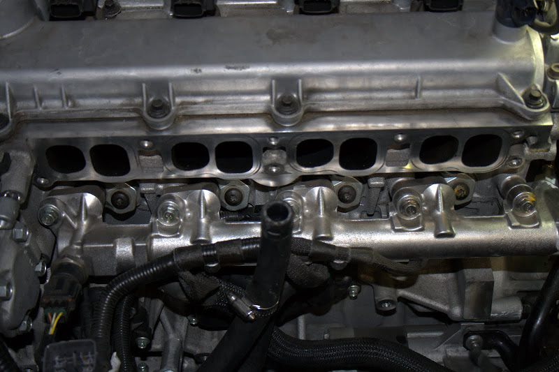

https://lh5.googleusercontent.com/_Z...0/IMG_1212.jpg
Intake

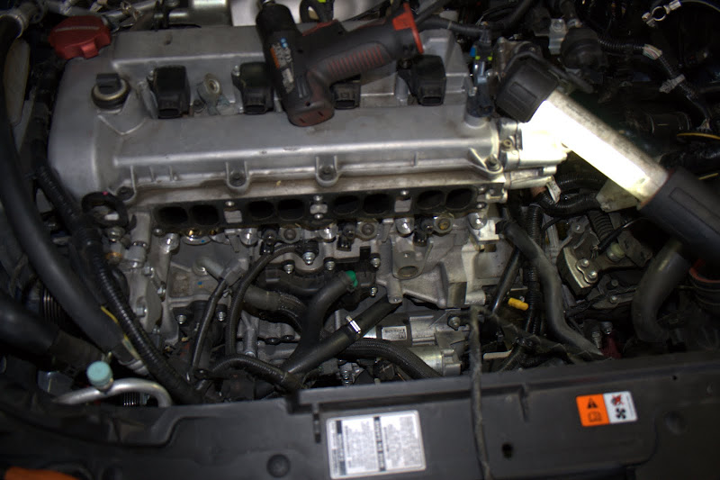

https://lh3.googleusercontent.com/_Z...0/IMG_1235.jpg
Fuel system yanked

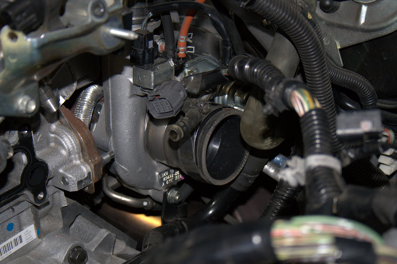

https://lh5.googleusercontent.com/_Z...0/IMG_1236.jpg
Turbo

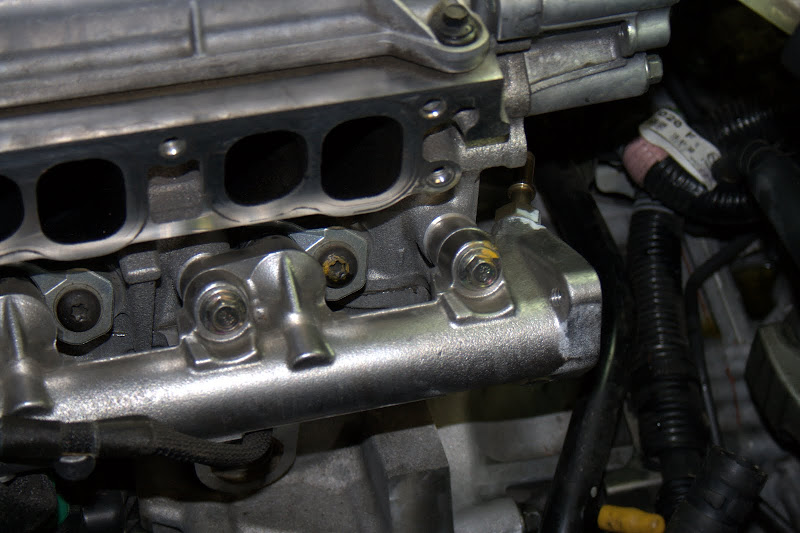

https://lh3.googleusercontent.com/_Z...0/IMG_1253.jpg
Fuel rail
https://lh6.googleusercontent.com/_Z...0/IMG_1254.jpg
Make sure you put these marked bolts back in on the right side. If they're reinstalled in a different order, Mazda may void your warranty.
https://lh4.googleusercontent.com/_Z...0/IMG_1260.jpg
Intake Manifold
