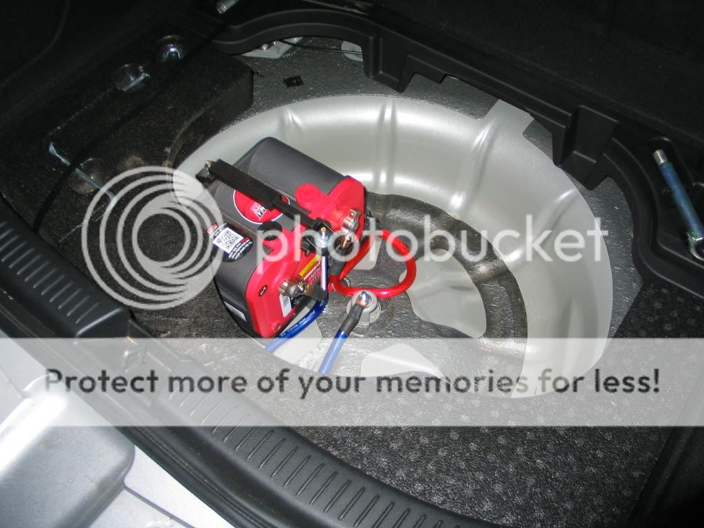

OK, we have all seen battery relocation on the MS3, and although thought I am not to that point yet, I am trying to determine the best location for the relocation when I get to that point. You are probably asking yourself, "why does this chump think he's too cool to put it in the hatch?"
I have considered that and don't think that is the best route for me for a couple of reasons. First, the battery sitting in the hatch doesn't look particularly "clean".
Evidence:
http://i142.photobucket.com/albums/r...C/IMG_0652.jpg
Secondly, I think it would interfere lifting the spare cover and make it tough to get to the spare. The last thing you need once you already have a flat is a headache getting to the spare. Finally, it takes up a fair bit of space.
QwkEvo did an extremely clean battery relocate to the spare location.
http://i429.photobucket.com/albums/q...ocation001.jpg
Thread
But I really don't want to give up my spare. I do occasionally drive to see family about 5 hours away. In rural Texas, it can be quite a hike to the next service station and or hours before getting a tow truck. I need my donut.
So to my question, has anyone relocated the battery to an alternative location or seen a very clean battery relocation that maintains the spare tire and tools?
I have considered under the seats, the passenger floorboard, even under the car but can't see to find something that looks clean.
All opinions welcome.
Thanks.
