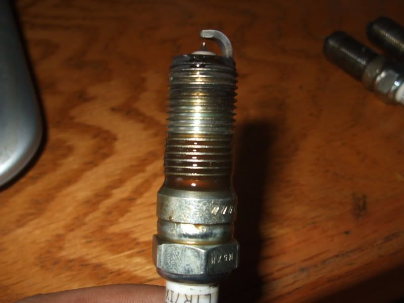

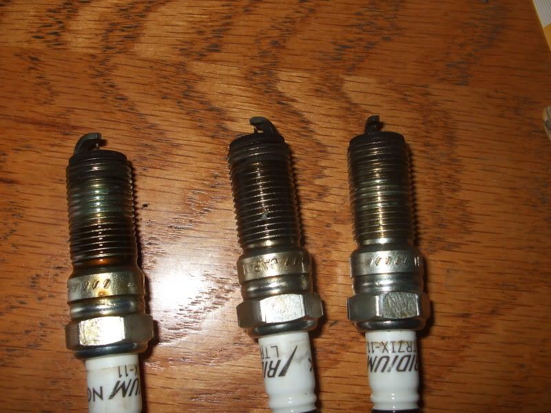

b-ron 12-08-2008 12:16 PM
i checked my spark plugs and wasnt to happy on wat i found
http://i20.photobucket.com/albums/b2...6/DSCF9100.jpg
http://i20.photobucket.com/albums/b2...6/DSCF9101.jpg
http://i20.photobucket.com/albums/b2...6/DSCF9102.jpg
b-ron 12-08-2008 12:17 PM
the oil is only on the threads should i be worried?
i checked all the connections they are good i will check the break pads
Darksun280 12-08-2008 12:24 PM
hmmmm Oil shouldn't be working its way into your threads as far as i know.
Grim 12-08-2008 12:42 PM
wtf,that oil should not be there.

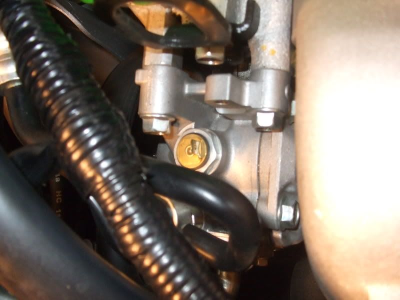

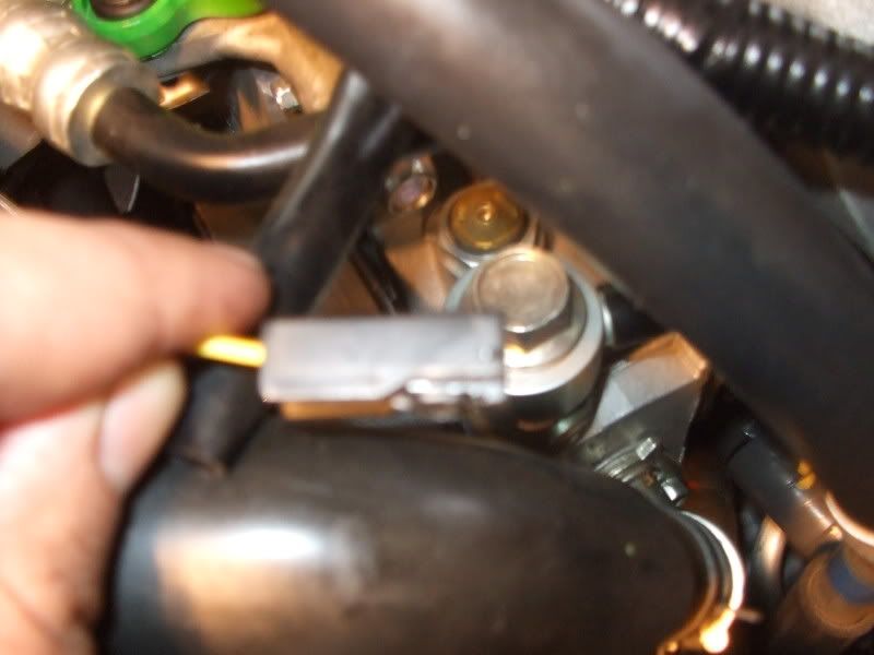

b-ron 12-08-2008 02:28 PM
i found this unplugged i have no idea why
http://i20.photobucket.com/albums/b2...6/DSCF9104.jpg
http://i20.photobucket.com/albums/b2...6/DSCF9106.jpg
b-ron 12-08-2008 02:29 PM
what is that plug for?
fbpem1 12-08-2008 02:50 PM
i don't have acess to my ESM here, what color is it, i can help you when i get home, and did you find what it goes to? is it a ground?

b-ron 12-08-2008 10:29 PM
ok i was talking to a tech that i know and he said that it is most likely the tps thats causing the reverse issue and about the spark plugs he said not to really worry because its on the top part of the threads and not at the electrode part of it
Darksun280 12-09-2008 07:40 AM
Ha oil last time I checked is not part of the combustion process. Think about that and let me know if oil ANYWHERE on the spark plugs is cool. When I had that on my cobalt ss/sc it was on cyl 4and it was oil blow by.
bova 12-09-2008 07:48 AM
ha its probably not on the electrode cause it burned off. has your exhaust been smoking a lot? check your pcv and make sure its not plugged up.
b-ron 12-09-2008 11:13 AM
zero smoke, and yes i agree about only being on any part of the spark plug but if it was a bad ring or somthing oil would be all over the spark plug hole but yet mine is dry as a bone so what i think happened was when i last took off the valve cover i was in the drive way and its a slanted back alot a lil bit of oil might have rolled in off the flat parts were the valve cover gasket meets the head. even it was a lil drop once its on the threads and you screw it down the oil will climb up the threads. just a shot im the dark on what could have happen
