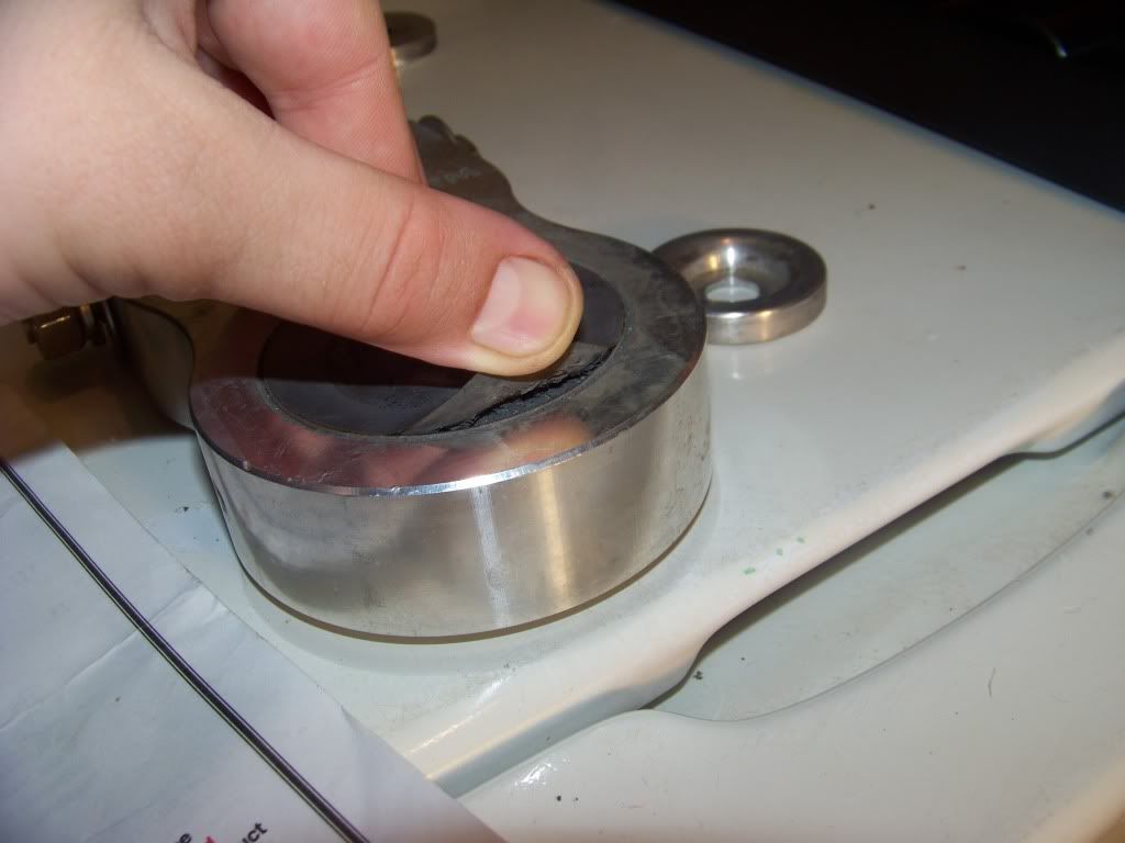

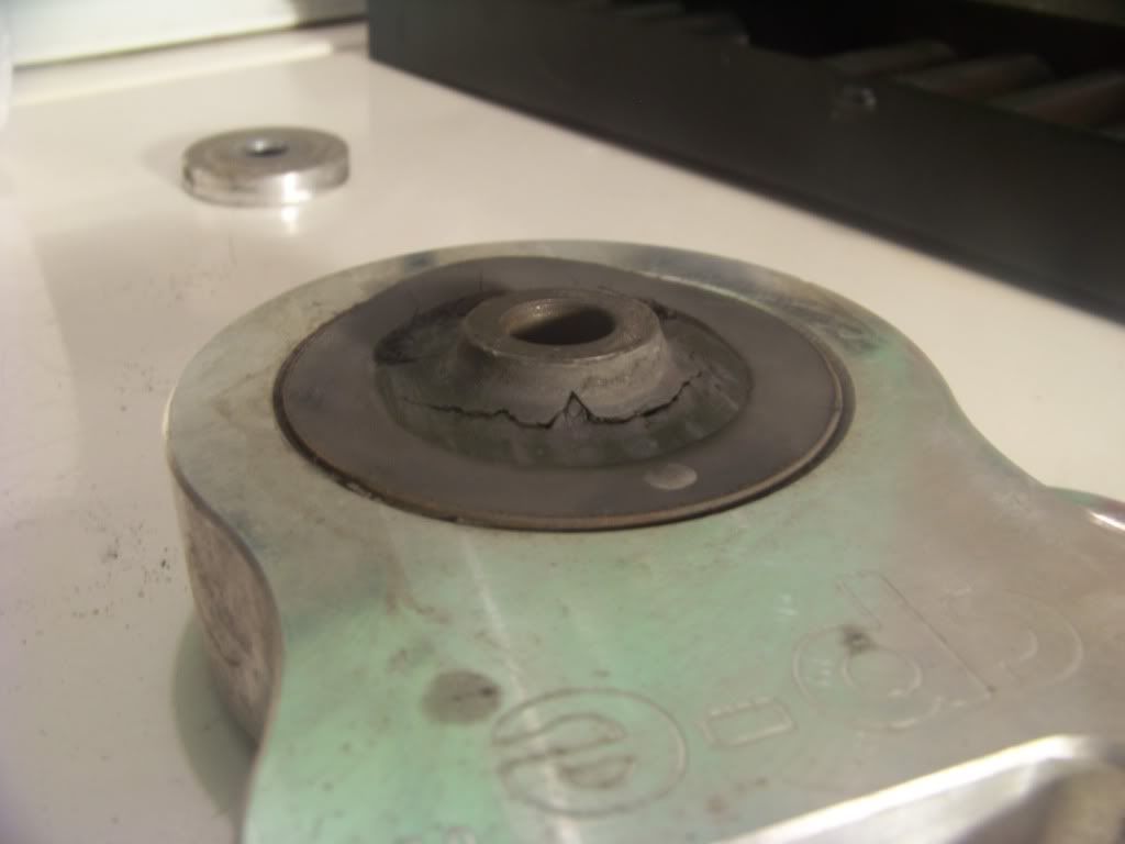

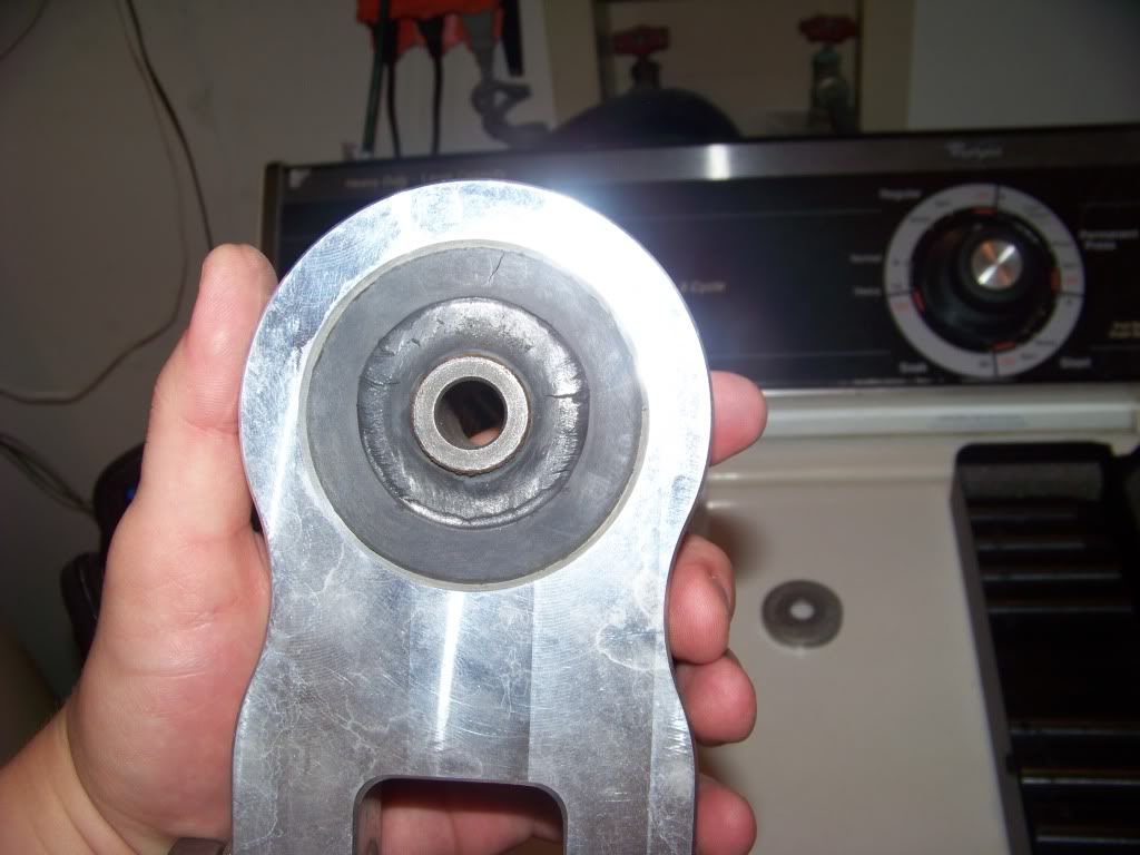

I've had this CP-E rear transaxle mount on the car for just under a year. I put my car back to stock recently for a dealer visit, and upon removing it noticed quite a bit of wear and tear.
Now, I certainly wouldn't go so far as to say that this is a part failure but this is definitely more wear than I expected to see.

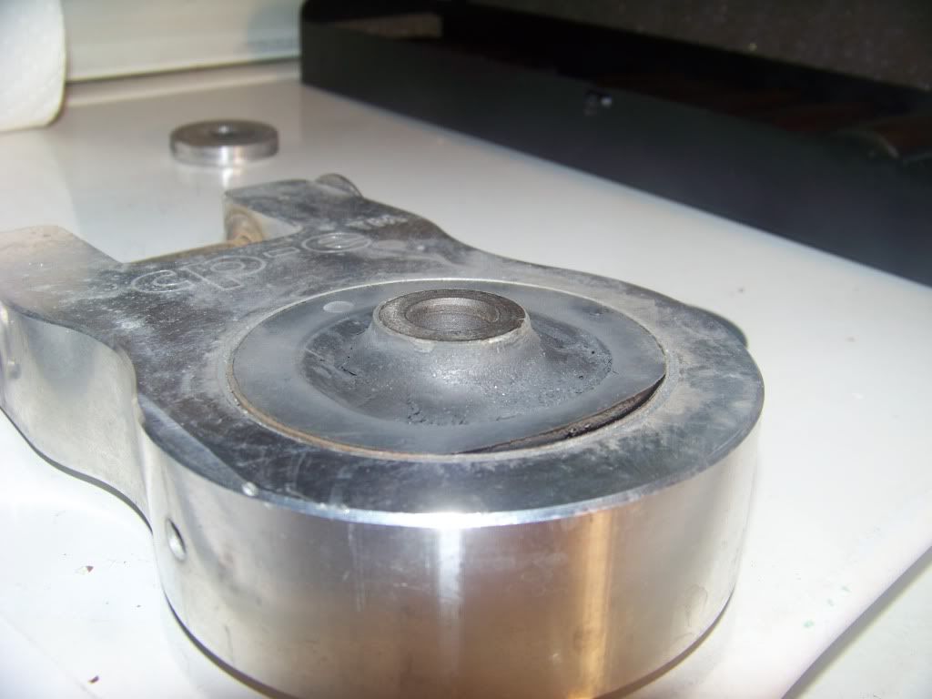

Other side:

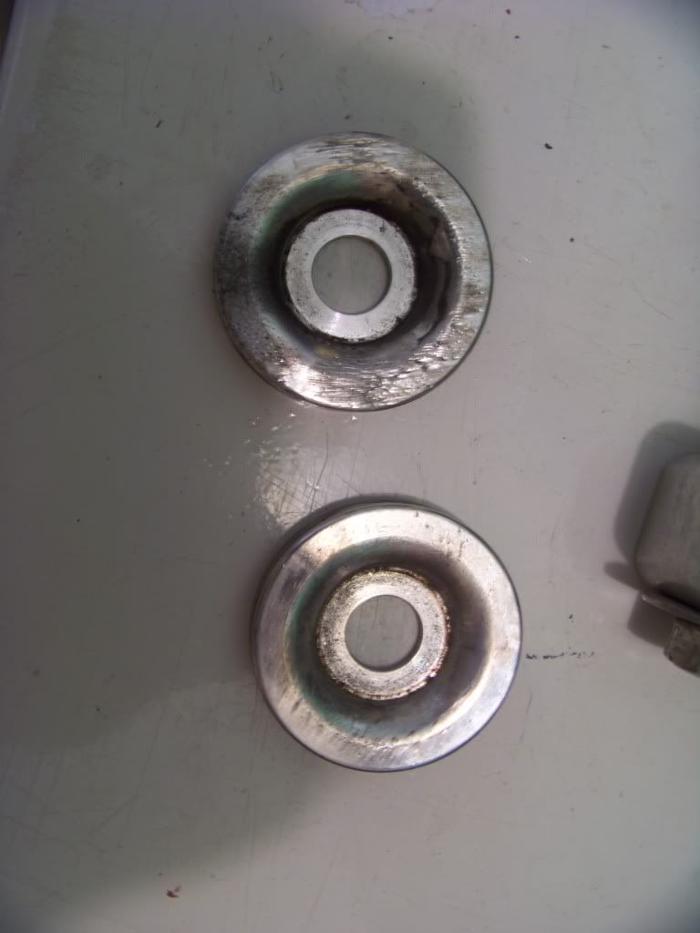

The condition of the "spacers":
Has anyone else experienced this, or is my mount the exception?
This is the 60 durometer version.
