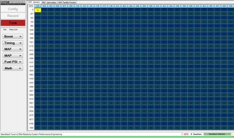

I was able to get the car running by adding fuel through the MAF
table in the Standback. Looked like this..

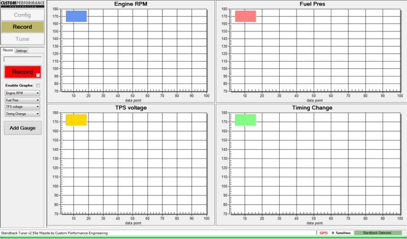

Took the car out to dial in the fuel settings. Had every gauge possible open and running.
On the SB I was monitoring...
On the dashhawk I was monitoring Knock, stft, boost, and afr.
I also had my prosport boost, AEM wideband, and prosport oil pressure gauge.

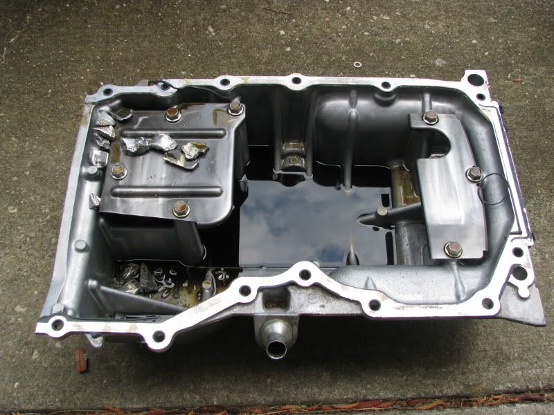

**Update** Some typical pictures from a blown MZR motor!
Peices of piston and block

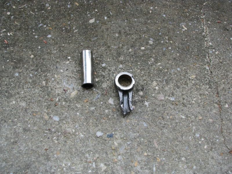

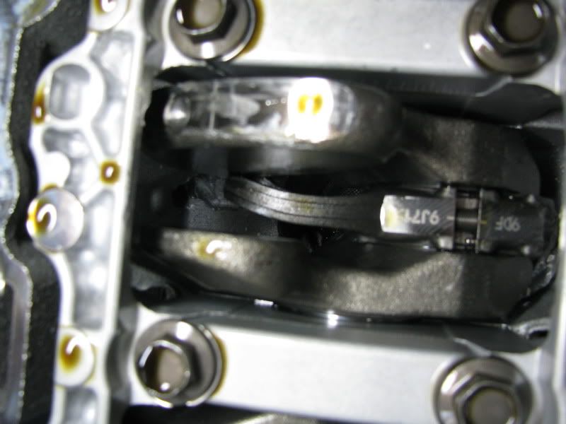

This is the weakest rod, although the other 3 rods were bent like mofos
RIP a 27,000 mile engine
