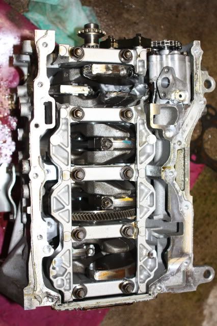

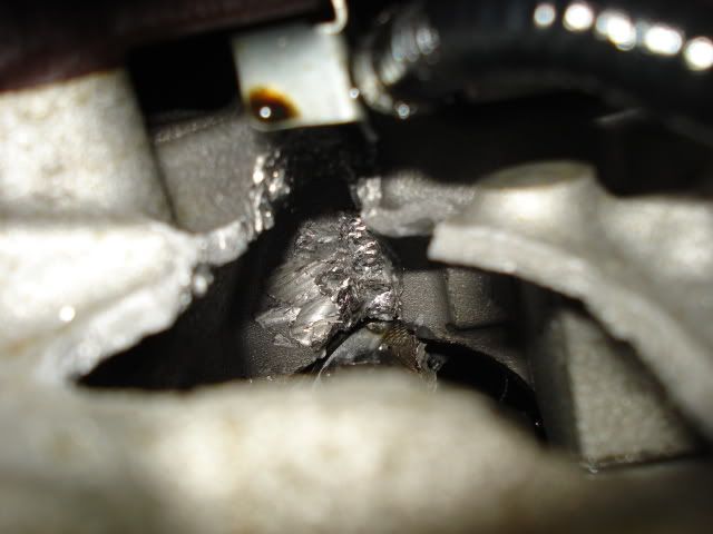

holeinmypocket 03-17-2010 07:44 PM
Blown Motor Pics! -4 LEX
I have a cylinder head, stock internals and a few other stuff for sale i would post them but my post count isn't high enough lol...ne ways i blew up this past july and finally got around to getting the motor pulled over the last couple of days....enjoi

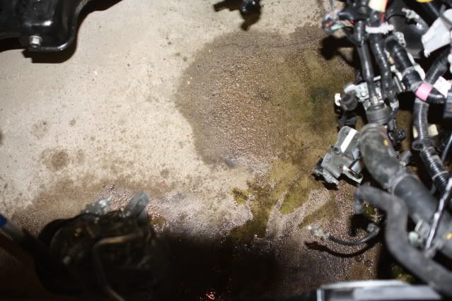

Motor Still In The Car
http://i220.photobucket.com/albums/d...s/IMG_4417.jpg
http://i220.photobucket.com/albums/d...s/DSC02906.jpg
http://i220.photobucket.com/albums/d...s/DSC02905.jpg
http://i220.photobucket.com/albums/d...s/DSC02904.jpg
http://i220.photobucket.com/albums/d...s/DSC02903.jpg
http://i220.photobucket.com/albums/d...s/DSC02902.jpg
http://i220.photobucket.com/albums/d...s/DSC02901.jpg
http://i220.photobucket.com/albums/d...s/DSC02899.jpg
http://i220.photobucket.com/albums/d...s/DSC02897.jpg
http://i220.photobucket.com/albums/d...s/DSC02892.jpg
http://i220.photobucket.com/albums/d...s/DSC02888.jpg
http://i220.photobucket.com/albums/d...s/DSC02885.jpg

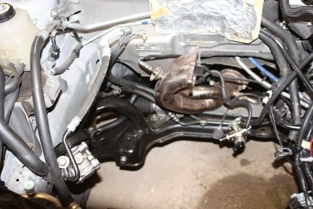

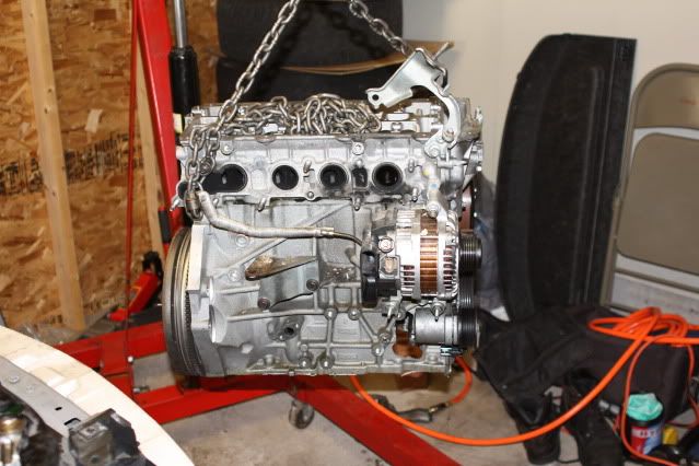

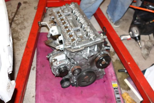

Getting The Motor Out!
http://i220.photobucket.com/albums/d...s/IMG_4802.jpg
http://i220.photobucket.com/albums/d...s/IMG_4803.jpg
http://i220.photobucket.com/albums/d...s/IMG_4805.jpg
http://i220.photobucket.com/albums/d...s/IMG_4806.jpg
http://i220.photobucket.com/albums/d...s/IMG_4807.jpg
http://i220.photobucket.com/albums/d...s/IMG_4808.jpg
http://i220.photobucket.com/albums/d...s/IMG_4814.jpg
http://i220.photobucket.com/albums/d...s/IMG_4815.jpg
http://i220.photobucket.com/albums/d...s/IMG_4816.jpg
http://i220.photobucket.com/albums/d...s/IMG_4817.jpg
http://i220.photobucket.com/albums/d...s/IMG_4819.jpg
http://i220.photobucket.com/albums/d...s/IMG_4821.jpg
http://i220.photobucket.com/albums/d...s/IMG_4822.jpg
http://i220.photobucket.com/albums/d...s/IMG_4823.jpg
http://i220.photobucket.com/albums/d...s/IMG_4824.jpg
http://i220.photobucket.com/albums/d...s/IMG_4825.jpg
http://i220.photobucket.com/albums/d...s/IMG_4827.jpg

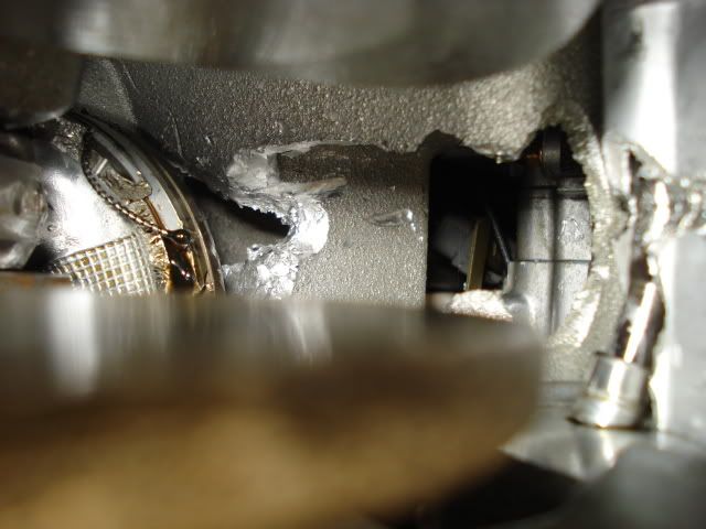

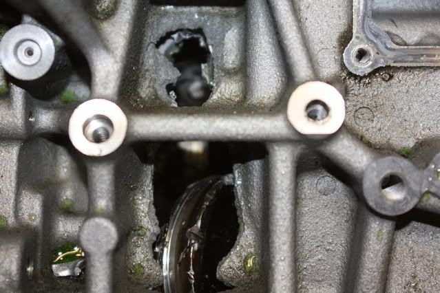

superskaterxes 03-17-2010 07:46 PM
why does it look like your head is brand new inside?

holeinmypocket 03-17-2010 08:10 PM
it's the flash that makes it look brand new...that is the head that i am selling has a bent valve..will need new valves...but shit it would be a good spare head for a PnP
Originally Posted by -cj- (Post 456296)
No warranty?
fuck no...did you see the bottom end of that motor...no balance shaft..plus fully bolted on stock internals

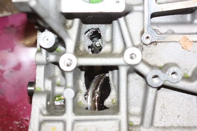

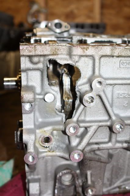

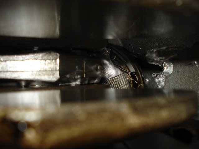

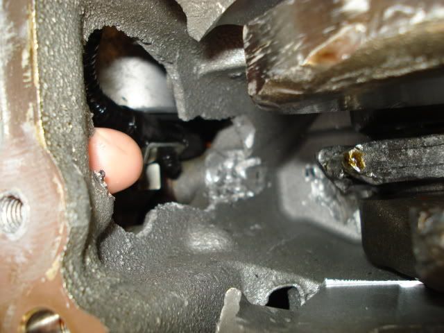

Shit dude, I would have dropped the balance shaft in through one of the holes in the motor and pushed the car onto a Mazda lot for warranty work lol.
Ghost Rider 03-17-2010 08:27 PM

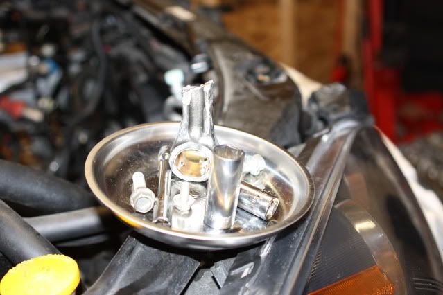

no wonder the motor blew; one of the photos shows quite clearly you had a finger in the block. Thats bound to cause some clearance issues.

Lex 03-17-2010 08:31 PM
Nice pics. How many miles did you put on it before it blew?
Are any of the other rods bent as well? It's usually not just 1.

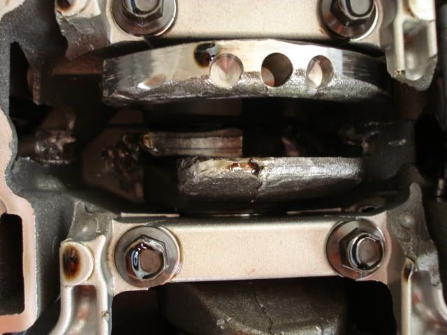

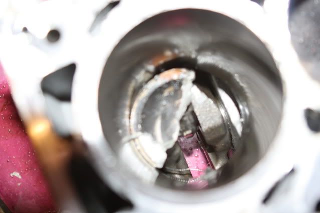

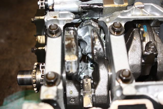

SO LEX WHAT DO U SEE FROM THE PICS? I haven't gotten that far yet what u see in the pics is what i have...do you want the shortblock lex...free just pay shipping lol otherwise i might clean it up and make a coffee table out of it for my beer when i work on my car in the garage lol
not as easy as it sounds...mazda opened my hood and saw everything and closed it 10 secs later and pointed me to the door lol

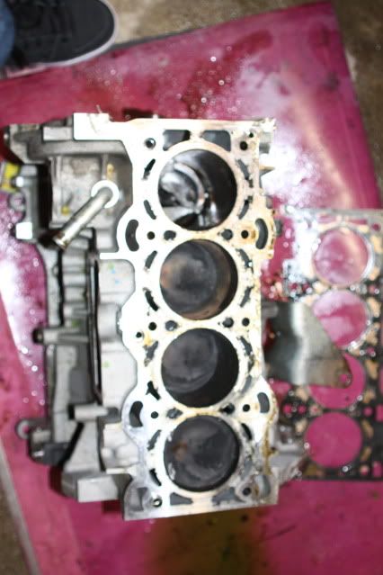

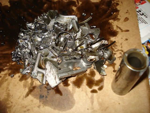

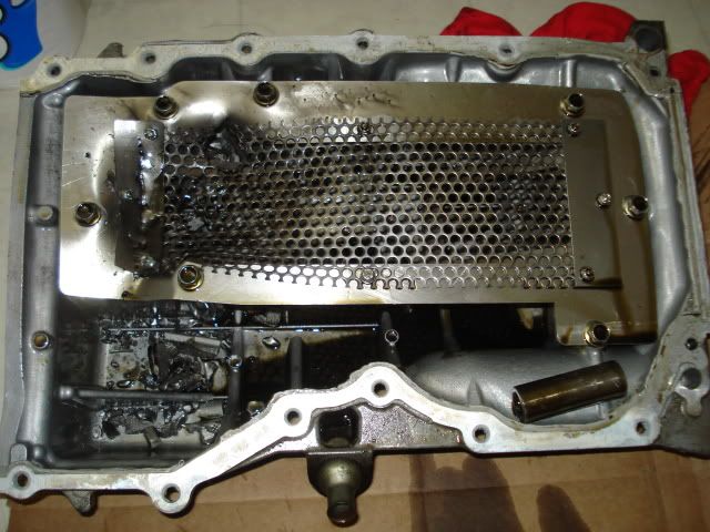

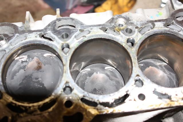

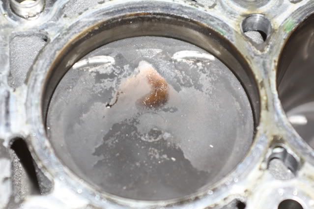

darth vader 03-17-2010 08:49 PM

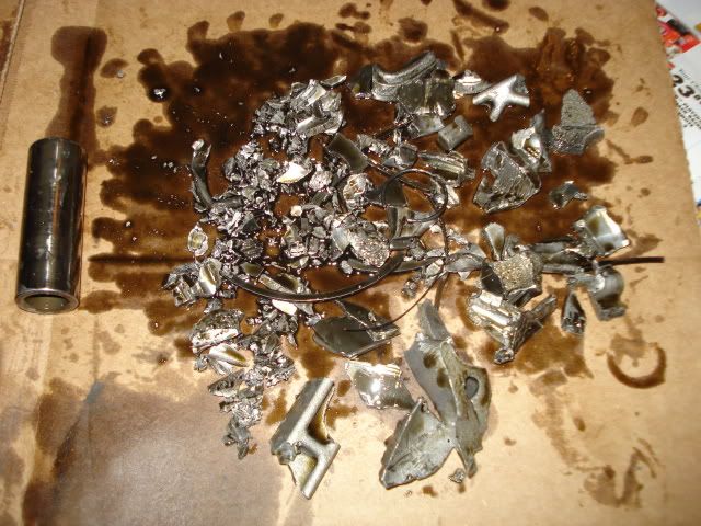

Mang, that some fucked up shit there, no telling the exact cause due to etensive frag...other than pushing the little car into an endless Viagra hard-on that finally came....at least you seem to be taking it well...I'd be :aargh4:
Soooo...we're talkin' ~21 psi reworked turbo on a stock tune with only throttle and no fuel cut flash + fully bolted air and exhaust...hmmmm, I wonder why it blew?

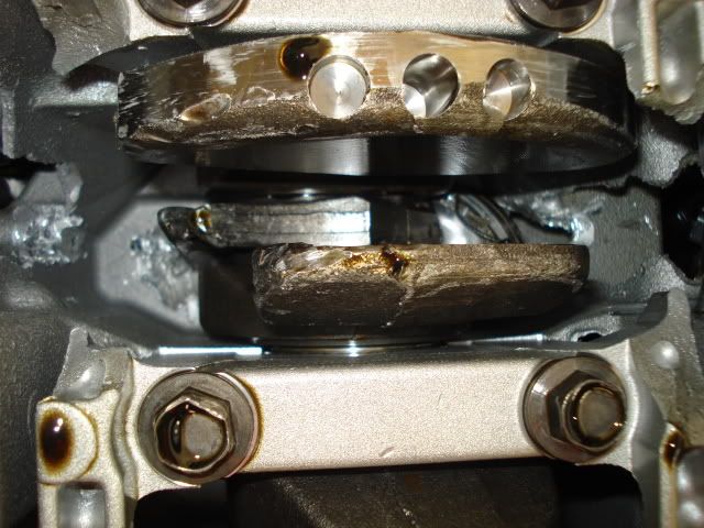

Lex 03-17-2010 08:56 PM
Shipping the block will be expensive and probably not worth it.
I see a couple of things:
1. Did you have a fuel pump? Did you have it from the time you started adding parts such as a turbo back exhaust? How many miles fully bolted?
2. You mention boost spikes, full control flash, not cut flash. How were your AFs? Any WOT knock?
I will be honest, the bottom end is NOT tolerant to spikes and high boost. Any low RPM spiking over 20psi is probably asking for bad things to happen. High load (highway) spiking is the worse and a few shots of detonation added to those low RPM loads bent a rod that finally let go.
Did you have any smoking or clutch vibrations prior to it blowing? What year was the speed?
Check the other rods when you pull them out for straightness. Any pitting on the pistons due to detonation?
EDIT: You mention you were running 17psi. What was it actually spiking to when you got on the throttle? I bet that with those mods a lot more.
darth vader 03-17-2010 09:00 PM
Lex:
Look at the piston pics, dude, they're all's well that ends badly. They don't show any signs of det and the edges near the lands don't show cracks from being pushed down either.
holeinmypocket 03-17-2010 09:06 PM
1. I bought the car already built like this...it had a Mr. Lilguy fuel pump.....i literally had it for two months and boom..i drove it for 5K miles during that two month period
2. I didn't have a dashhawk at that point the funny thing is that i had one on order that week...yeah i mean full control flash and no cold cut flash from CPE...i could here knock mostly in the lower rpms...
3. it was a 07 GT with 35K...smoked alot 20 mins prior to blowing up while i was at the bank drive thru....i honestly couldn't tell you about the vibrations cuz i had trz rmm and tranny mount...lol
spike to like 20 psi in 3rd thru 5th ...sometimes when i would go in higher elevations my target boost would be 18-19 psi for some reason due to the elevation ...i didn't like how the car felt like that
Lex 03-17-2010 09:09 PM
Aw shit, you're the guy with tru-boosts car. Doesn't surprise me it blew. Untuned and that thing was beat on. Word got out that you weren't soft on it either.
If you heard knock, it was definitely a problem.
The smoke prior to it blowing meant the rod bent. Do you remember what you did just before it started smoking? Hard pulls? Anything of the sort?

It was smoking before it blew because the rod was bent and the piston was skewed in the bore and the rings no longer sealed properly.
Many people notice excessive smoking when a rod is bent.
