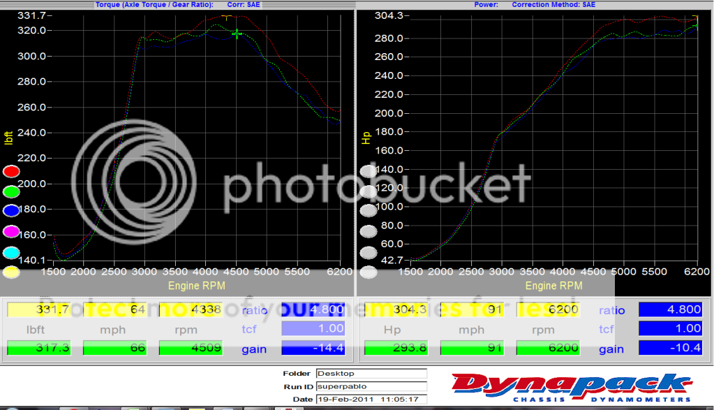

or do something like me. Im at 305hp 340tq . I have similar mods, except catted DP and ETS TMIC.. good tune though, so that makes a difference it could be that i need to push a bit harder on the tune if i were to compare to someone with catless dp

unless you get a reworked k04, you arent getting 300whp on the stock k04

orlly?
I disagree. Stock k04.
http://i755.photobucket.com/albums/x...o_/dynoday.png
and i guess ill correct myself on the torque. Its not 340, its 330
IshiKage 05-18-2011 09:17 PM
dynopack...nuff said.
go to a mustang dyno or better yet, whats your trap speed in the 1/4

u have room for improvement. Get a downpipe and a tune and your car will open up pretty nicely... Those are the two mods that made the biggest difference for me... dont worry about the numbers so much dude... you will be plenty happy with those two upgrades... at least for a while. I guarantee it.
as far as it being a dynapack... true, they read higher than mustangs, but then again... theres still room for improvement getting methanol injection. Id agree that 300 is pushing the k04, but I disagree in claiming its not possible to get to 300 on the stock k04. Either way. Im very happy, Im sure expoz3d would be too with those two upgrades i mentioned previously.
