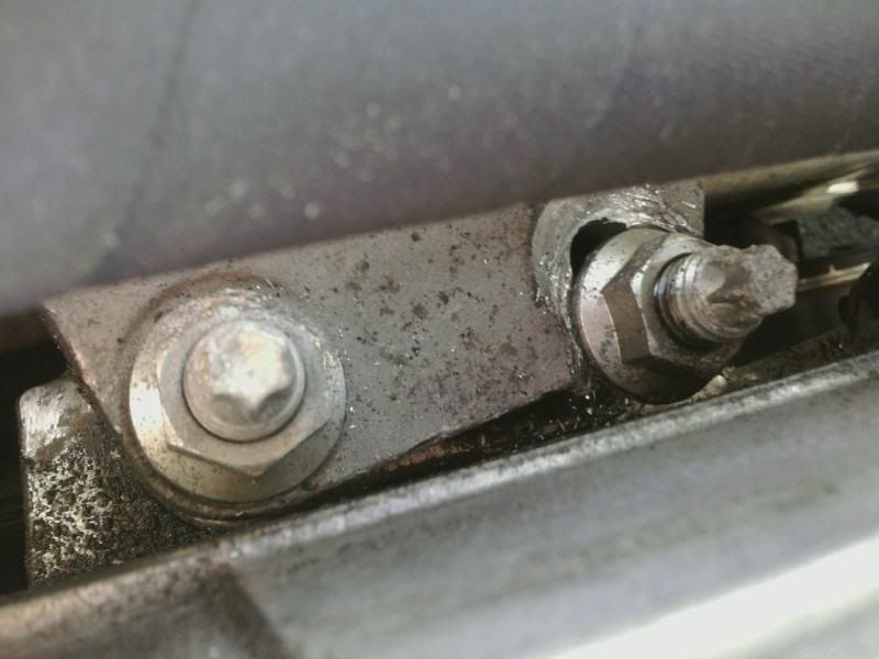

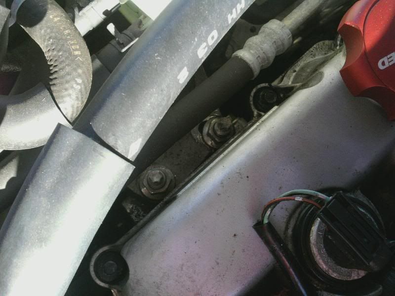

So on saturday i went up to New England dragway, Had some great runs (wet track, limited us to only running 1/8th miles) But on my 13th or 14th run I think i broke my motor mount, because i took a few more runs, my launches were shit and it sounded a bit different. So below is what i found.
http://i88.photobucket.com/albums/k1...icture-1-1.jpg
http://i88.photobucket.com/albums/k1...icture-2-1.jpg
http://i88.photobucket.com/albums/k1..._picture-3.jpg
So as you can see the PMM, failed on me and the aluminum on the bracket snapped from around the stud.
The issue is one of the studs is also bent it appears, and i am concerned about how that will effect the repair.

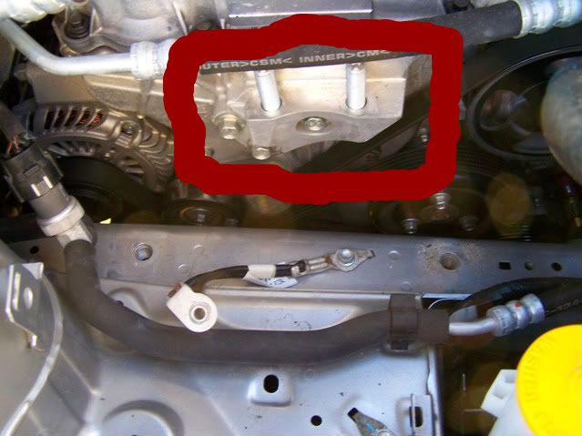

Can Anyone tell me what the part# or what to call what is pictured below.
Note - this pic is not of my car
http://i88.photobucket.com/albums/k1...ssmm9JPG-1.jpg
(stolen from bioevolve and edited)
I think i will need to replace that piece.

i think the red piece looks okay.

The boss for that mount is part of the timing cover, and your looking at ~6 hours of labor at the dealer if you have to replace it... The crank pulley has to come off so the motor will need to be re-timed.. The timing cover itself is about $300...

Damn, guess i got to hope a new mount will go back on there.
I guess i could always try and lightly hammering it back on

MATT DAMOND 04-11-2010 08:32 PM
If what SSinstaller said is the case, I'd just replace the stud.
