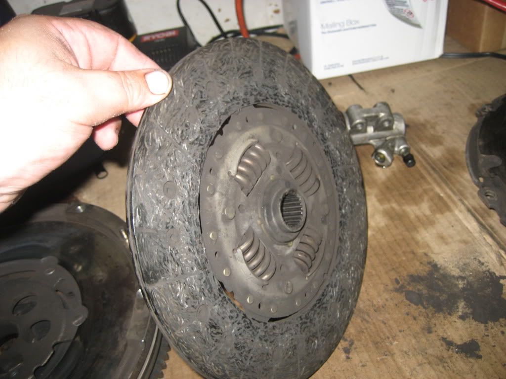

needless to say it was down to the bone....

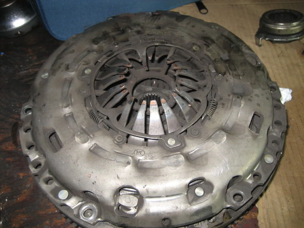

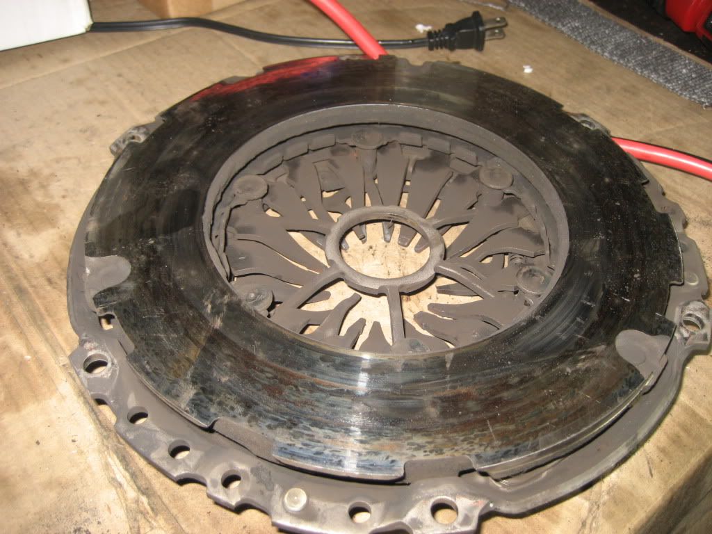

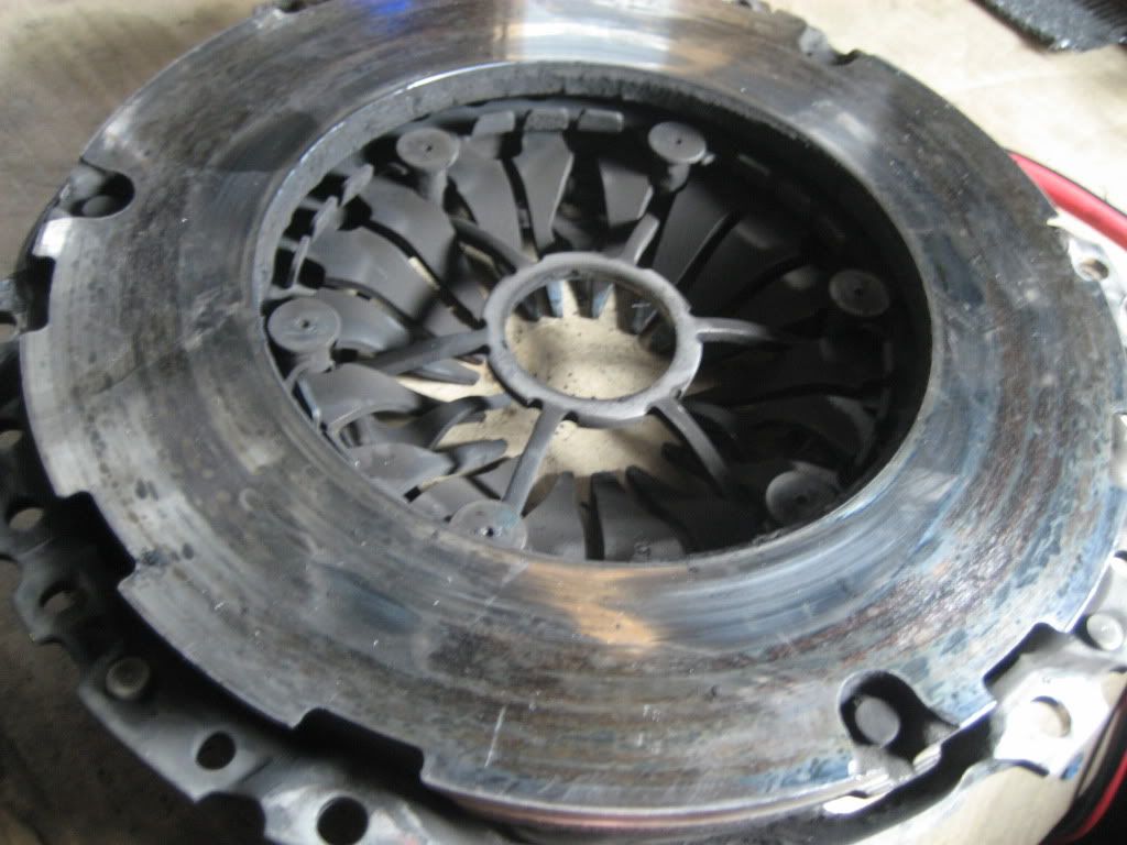

stocker pressure plate

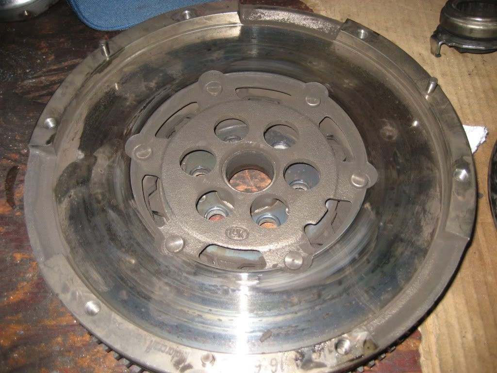

flywheel with its high spots in the greyish blue spots

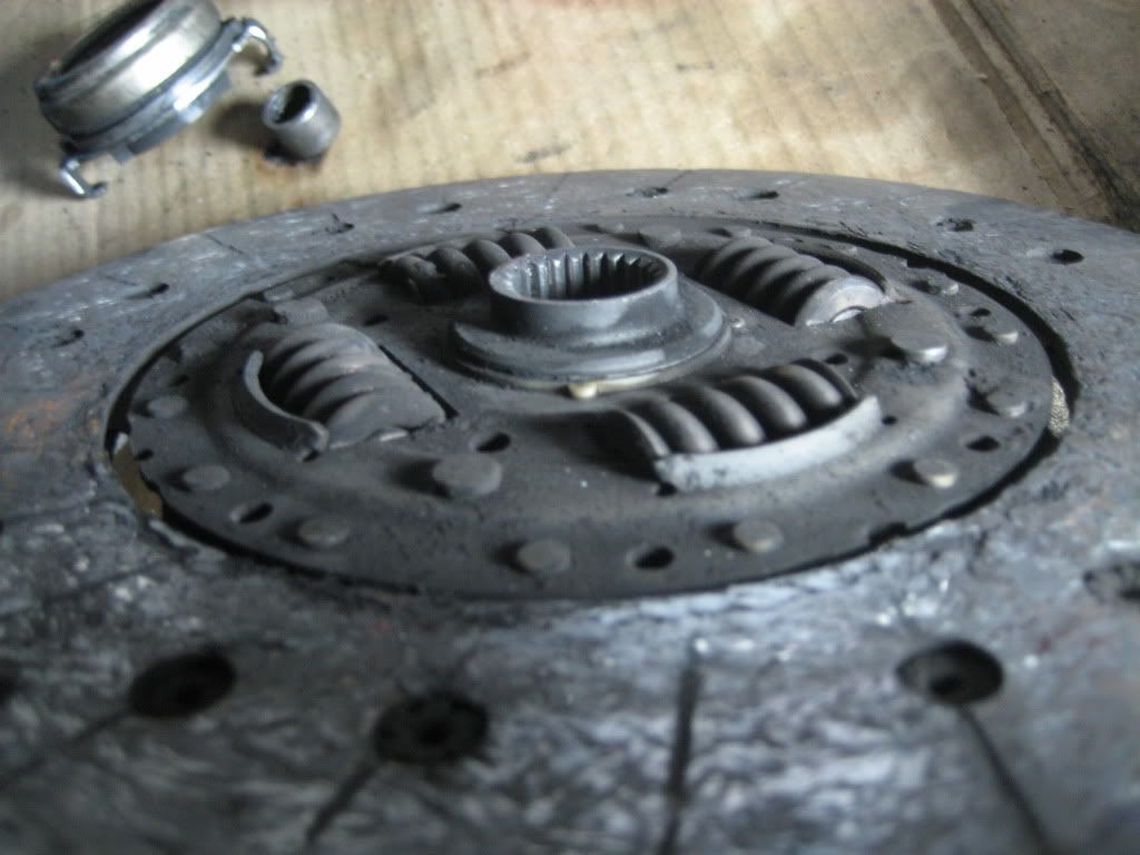

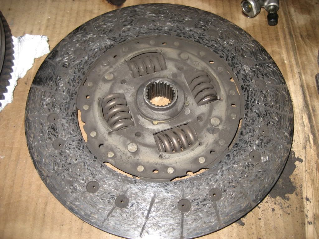

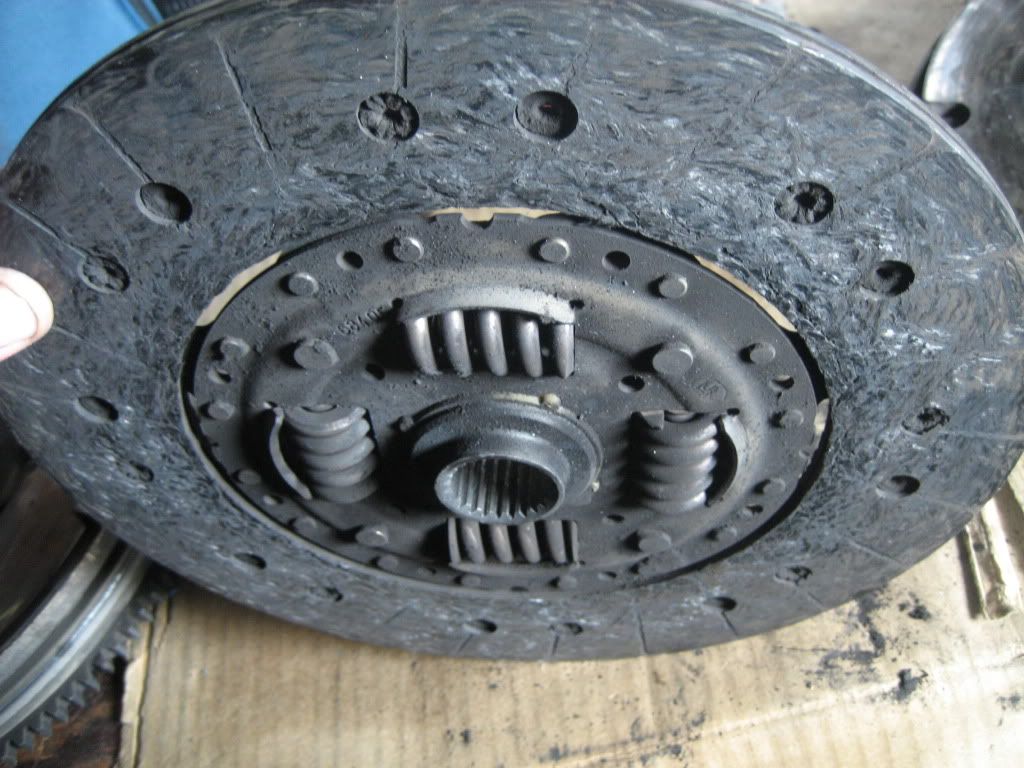

heres the actual clutch disc... u need to see during daylight to fully appreciate it lol

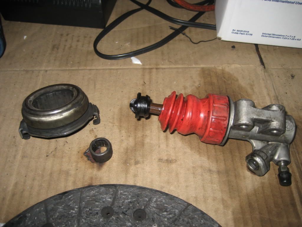

and finally heres the throwout bearing that sounded like a keychain when spun.... a leaky slave cylinder that i replaced with the revised version... and pilot bearing that was a motherfucker to pull out

Tell me about this revised slave cylinder, is this a factory pc?

from what i have been told.... the slave cylinder we have is prone to leaking once combined with a stiffer pressure plate .....
I forget the part number for the new one starts with B and ends with B.... and from what I was told that means it is a revised part. mine indeed leaked immediately... i got lucky and the dealership had a new one.
as far as can u do this in your backyard.... yeah... u need a couple of jacks... a couple of extra hands....(like 2 more guys) and a shit ton of time....and patience... alot of work!!!

Originally Posted by hnda etr View Post
We used a large prybar to wedge the teeth of the flywheel against the ground.. So when torquing the bolts, the flywheel teeth engaged with the prybar and kept the assembly from rotating
Thanks for the tip, today im planning on swapping my street disk to a 6 puck.
and sorry but i am not doing a how to.... I would feel comfortable speaking on rebuilding an automatic transmission and its components.... but manuals are not my area.... although I paid attention to when it was being done today.... alot of work man....and that fucken tranny is hard to control on the way back up.
FYI I have about 500 miles on my new ACT Street kit and OEM slave with no leaks so far. Keeping my fingers crossed, I didn't know about the issue with it.

Originally Posted by 11cruzito11 View Post
Hey Lenny,
I have a question for you, how were you able to hold down the flywheel to torque down the flywheel bolts?
put a wrench on the crank bolt on other side of engine.. use that to bind it down enough to torque the bolts down....

Lenny's slave leaked as soon as we disconnected it from the transmission... even before the ACT clutch was installed...
Fluid came pouring out of the orange dust boot...
Status?

Wow it does look razor think...What is the thickness of a "new" clutch material?
Status?
I have the tranny up now with the new 6-puck clutch, what a PITA haha. Damn driver axle is a bitch to take out. I have a nice trick I can share with people on how to hold the flywheel to torque down the bolts the 111 ft.lbs required.
Worked on it on Sunday for about 1.5 hours, 1.5 hours again on Monday and dropped tranny.
Today torqued down flywheel and put tranny up. Tomorrow I should assemble everything back.
11cruzito11 is offline   Reply With Quote
There's a one time seal inside the feeder nipple- the nipple that has the aluminum feed line coming from the master cylinder. It's pressure based. Once you disconnect that line from your slave cylinder you're shit out luck because it stretches when the line is pulled out.... the only option is to replace the slave cylinder.
Slave Cylinders don't just leak because of a new stiffer pressure plate.....just a fyi
EDIT: If you don't want to spend money buying a new slave cylinder don't disconnect it from the feeder line that's coming from the master cylinder. Plus, there's really no reason to remove it because you could move it out the way when pulling the tranny.
Share your trick man... don't just waive it around like that.... Is it the flat stock with two hole trick i mentioned to you a while back?
Actually, it's a steel hard line, not aluminum - aluminum wouldn't be able to withstand the pressure.
Also, the seal that goes onto the fluid hardline (fits into the cylinder) is reusable. It's not a soft rubber that stretches out - it's a pretty firm rubber that you re-use. Buying a new slave cylinder wont help because that grommet is NOT included with a new slave cylinder you HAVE to reuse the one you have.
Also, the original part A version of the slave cylinders are prone to leaking - hence why Mazda now offers a countermeasure part with the "B" revision number.
And please explain to me how running a stiffer pressure plate, which requires more pressure from the slave cylinder piston to push it out, does NOT contribute to failure of the slave cylinder... After all, if it takes more pressure to push the clutch pedal down, it's logical that that increased pressure would contribute to increased wear and tear...
EDIT - I've done 2 slave cylinders now, so I have some experience with this...
Is something like what "hnda etr" mentioned using a pry bar.
Let's see if I can explain it, damn I should of taking a picture of it.
Around the bell housing on the side close to the starter there is a slot that a guide goes into the tranny side. We used a 3/8 extension (like a 5inch one) and put it thru the hole in the guide so it would face forward. Then we used the pry bar to get a hold of the teeth on the flywheel and lean it to the 3/8 extension so it would grip the pry bar and stop the flywheel from moving.
Since the passenger mount is only holding the engine, i had one person holding the engine from moving sideways and another person holding the flywheel with the prybar while I torqued the bolts to the 111 ft.lbs.
Hopefully I explained it good, does someone know exactly what that "guide" is exactly called?
