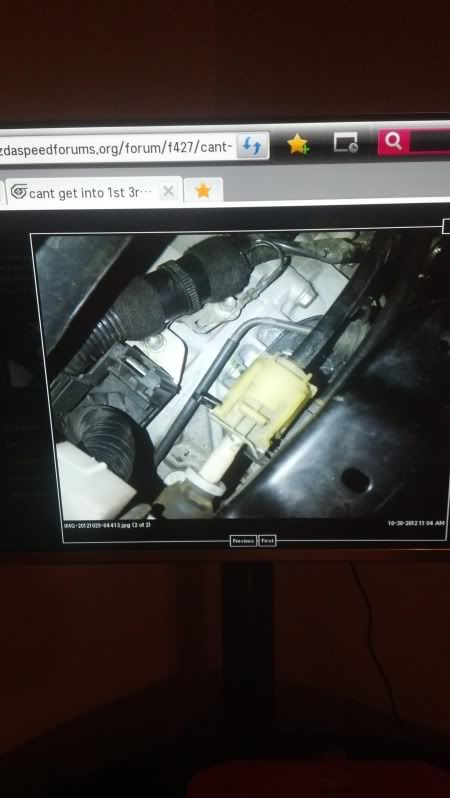

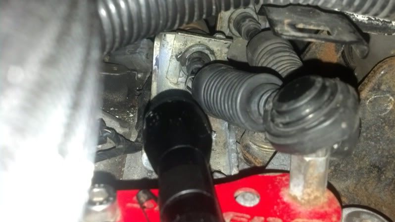

I'm missing the 2 white plastic pieces on the shift linkage
This is what mine looks like (not a over head view)

so...your looking for a new cable.?

I remember when I broke my plastic sleeve for the shifter cable. I did it installing the JBR ssp. If the 6 is like the 3 then yes you will need a new cable because eventually the cable will snap and the only way you will get in gears will be to manually grab the linkage in the bay and put it in a gear (I had to do that to get to a dealership). Try looking for a used one if you can find one.

You do realize on a speed 6 that dash has to come out to replace the cable?
