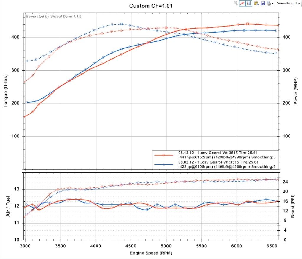

Boost_creep 11-18-2012 04:39 PM
I saw gains after adding my Racing Beat catback. They weren't huge, but there were gains none the less.
I think I have a VD chart of a before and after (on the same map). I'll post in it a bit, if you would like. :)

Boost_creep 11-18-2012 07:30 PM
I know this isn't a real Dyno, but it gives you an idea. These logs were done one day apart (so very close ambient temps), and on the same map.
cld12pk2go 11-18-2012 07:52 PM
All my detailed before/after data is here:
http://www.mazdaspeedforums.org/foru...xhaust-121759/
Here is just the VD:
http://i77.photobucket.com/albums/j6...Ebothat69F.jpg
It would appear that from 5000 RPMs and up I have gained right about 20 WHP. It certainly feels like it pulls a fair amount harder up top and multiple Virtual Dyno logs appear to confirm that the above is not a fluke (other than the higher torque on the lower RPMs range with the stock CBE, that does appear to be anomalous to that pull).
