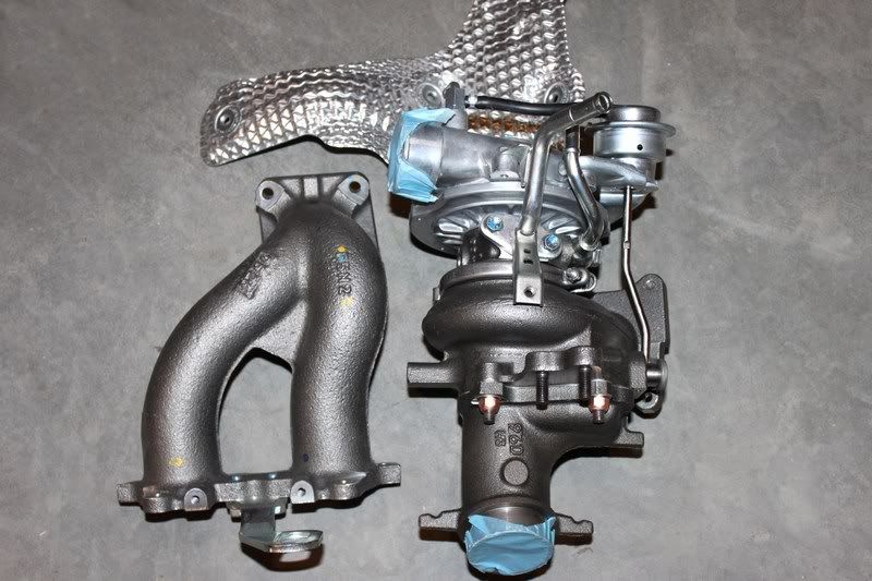

Default Ceramic Coating or Header Wrap
I bought some heat wrap and stainless ties then found a shop to ceramic coat my manifold for 130$ in black, so i will return the heat wrap and ties which was only 30$ and i got a turbo blanket for 60
my question is how well will the ceramic prevent the heat from going into engine bay or was header wrap still a better option.

My plan has been to find/get a turbo blanket and a full ceramic coating. Based on what I am reading though, a wrap and sealing coat of high temp paint is the best on the DP and manifold.
Any turbo blankets around for our K04?
What about the stock heat shield? Would a heat blanket help there as well?
I am thinking as little "under the car" time as possible here (I have no garage, no jack stands, and live in the land of eternal rain Portland Oregon).
The NASTY thing is that my BATS are horrific and am trying to figure out how to help manage the heat soak.
