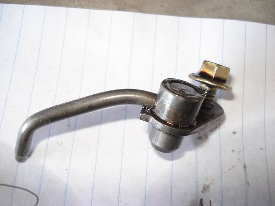

So changing the oil today and i found this attached to my drain plug.
http://i48.photobucket.com/albums/f2...0/IMG_0009.jpg

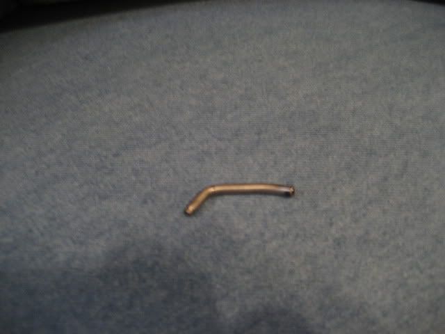

Looks like its an oil squirter that broke off. Not really sure how it happened but it looks as if there is an imperfection in the cast near where it bolts to the block. No contact marks where the piston is or anything.

Wow...I'd take it up to Mazda
Sacrilicious 02-17-2010 01:42 PM
DEFINITELY take that in to mazda! i dunno wtf that is exactly, but it sure as hell shouldn't be sitting loose in your oil pan!
Jarods7920 02-17-2010 01:50 PM
Mazda wont do anything its a built motor. Its a piece of an oil squirter. Soon as my parts guy gets back from lunch i am going to order a new one. I dont really think taking one from my old block is the smartest idea.

ahhh...didn't realize it was built. ya, definitely get this resolved.
Jarods7920 02-17-2010 01:59 PM
I intend to...not much of concern since the car goes about 7 miles a day anyway and i have not driven it hard in a while. But glad i noticed it. Just get to add it to the list of things to do when it tear it down next week.

predapio 02-17-2010 02:06 PM
Is that a tapeworm?
Jarods7920 02-17-2010 02:07 PM
I didnt used the squirt off of anything. That is one of the original squirters that came with that block. I was just saying i dont wanna use one from the block that i broke a rod in and vented the block.

Ya thats what i am thinking. I know that had to be removed to bore and such. Where its broken looks about where it bolts to the block so its either a casting flaw or it was dropped or something when it was disassembled/assembled. I will let you know what i find.

Are you SURE it wasnt hit? I think the only way it could fall out and not get hit is if the engine wasnt running, there is probably less than a 1 in a billion chance that it could fall out with the engine running and nothing hit it.
Jarods7920 02-17-2010 07:53 PM
Yes I am 95% positive it was not hit. There are no contact marks on top side of it that would be indicative of the piston hitting it. Ifthat were the case either I would have brokenor bent a rod or all 4 would be broken off. Where it looks like it was hit is rift St the point where t attached to the bolt portion and that part is covered by the block overlap. So, conclusion isthat it wa wither dropped or damaged during onstallation. Once I pull the pan I will know for sure.

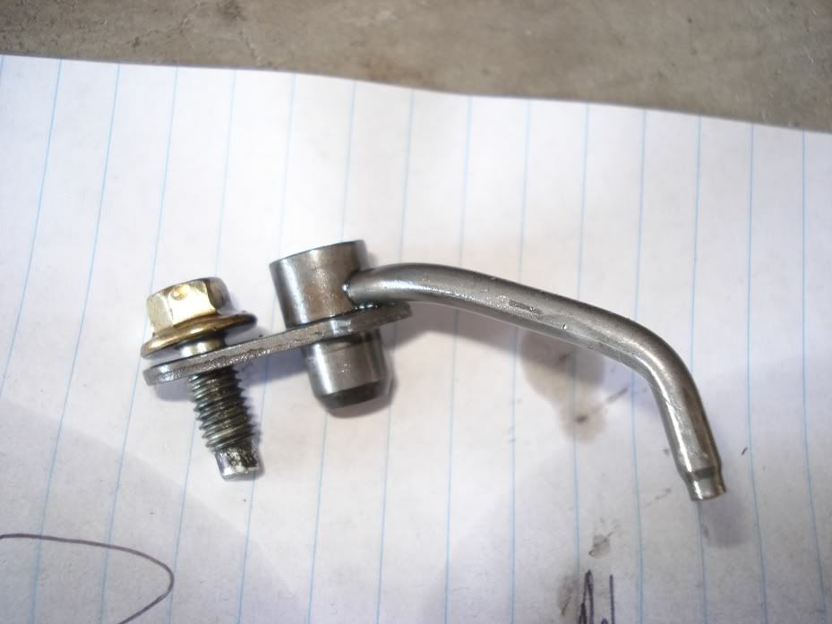

Here's some better pictures so everyone knows what it actually looks like complete:
http://i359.photobucket.com/albums/o...quirtsmall.jpg
http://i359.photobucket.com/albums/o...uirtsmall2.jpg
http://i359.photobucket.com/albums/o...uirtsmall3.jpg
Curious to see the outcome of all this.

Get that resolved as it will affect oil pressure in the engine. Do you have an oil pressure gauge? Is it still within spec?
You can see the squirters if you pull off the pan.

Hmmm, IMO it wouldn't affect oil pressure if the bolt and base banjo fitting are still in place. It would definitely affect the piston temp of the one missing the squirter though.... Looks like a simple case of a poor braze/weld on the squirter itself. A pan pull and replace is pretty simple so shouldn't be a problem to fix.....

Our oil squirters have a spring loaded ball valve that only opens with enough oil pressure, I dont know how much it takes but they feel fairly stout to me so it could be fairly high pressure.

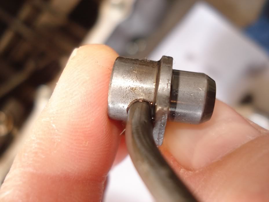

Ya you're right i was an ass, but when i have explain that there are no contact marks to on the piece that would be indicative of it snapping off due to contact i would agree. However in there areas where it would have been contacted to cause such a problem there are not visible signs of damage.
The only thing in conclude at this point is this:
1. If it were due to rod/piston contact it would have shown before now and would have been in the pan when i pulled the pan before.
2. Rods and pistons do not move out of their set path unless there is a problem.
3. After examining the piece of the squirter i have it looks to be a poor braising joint.
I apologize for being so harsh, sometimes i just come off that way. I deal with a lot of stupid people at my job so at times it can spill over into everything else. Sorry for being a dick, i understand you were trying to be helpful.
I am going to pull the pan tomorrow morning after i get home from work and inspect and change the squirter. I will post my findings and we can further deliberate on this subject.
