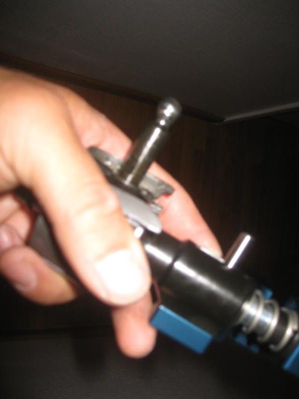

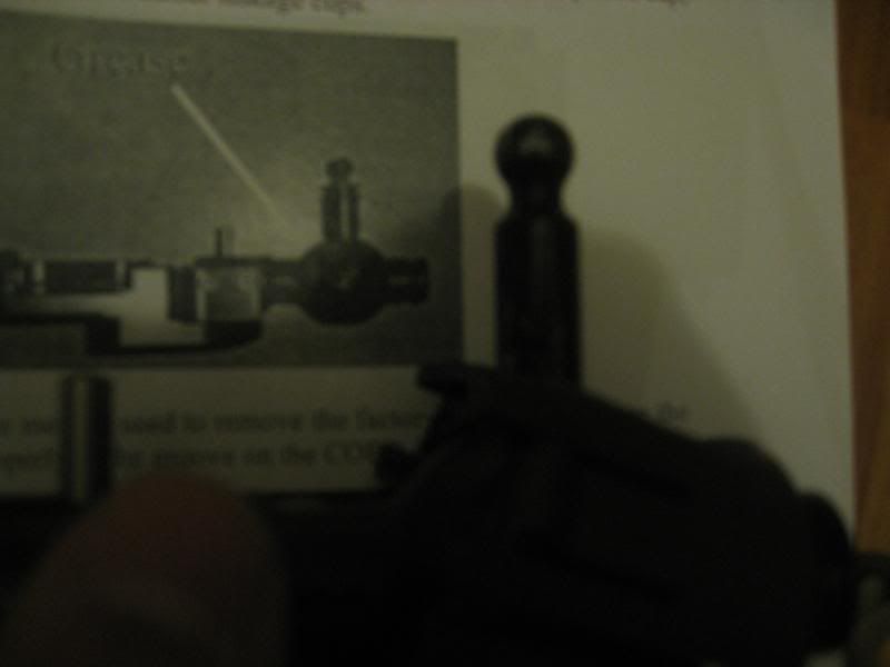

Blurry but to the point..

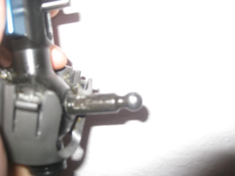

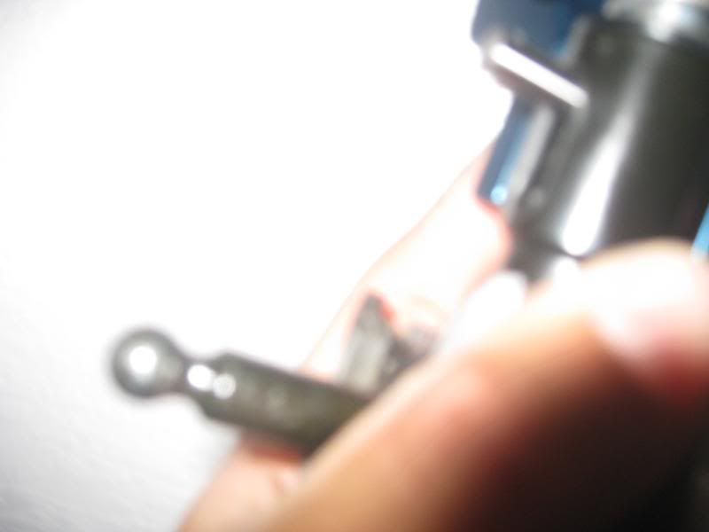

And heres the smoking gun..
I was messing with the gears and the spring just slidesback and forth along that nipple. Freakin lame.
COBB I hope you guys are gonna make this right.... I waited and waited and got this...

I just installed mine. Mine does have the grooved collar that yours is missing. I know what you mean by the top section having slop. The part with "Cobb" engraved has a small amount of rotational play.
1st and 2nd seem pretty easy to find without the weight. Without it, its very notchy, with the weight, its very heavy... time to make my own weight I suppose.

You are missing the plastic slide over peice, double check your box. Or maybe someone from the place you bought it from needed a replacement and decided to take yours lol.

Originally Posted by bioevolve View Post
I was going to start installing mine after the re-revised shaft came in yesterday and thought to check the site for any probs with it lol. I found your thread and had to check mines.
First thing I do when I get the package is pull everything out of the box. i did NOT get one of those. Why the hell would they make the entire shifter out of metal and then add a POS plastic piece to go over. Its obvious this piece is needed to funtion properly cause I have a VERY hard time finding 1st and 2nd gear while downshifting.
1990 Totoya Corrolla DX TRD limited edition w/ Back to the future Delorian body kit/ K&N snorkel inlet ram-air intake/ Mazdaspeed T3/T4 turbo-supercharged hybrid 5 PSI and many more mods. 11.92 @120 MPH
Probably a revision on the cheap, instead of making a solid metal piece and sticking back in the base of the ball. Just made a POS plastic piece to go over it.
Unless it acts more like a bushing (which it probably does). Some are metal, some brass, some plastic or rubber.
By the way, it was already on my shaft and does come off by hand.
