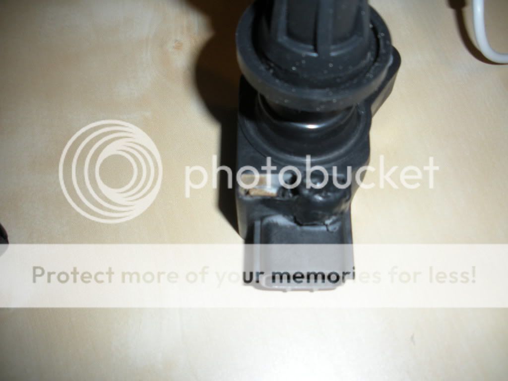

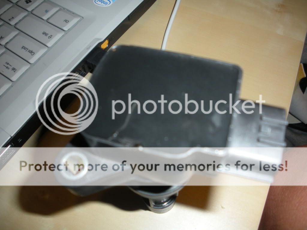

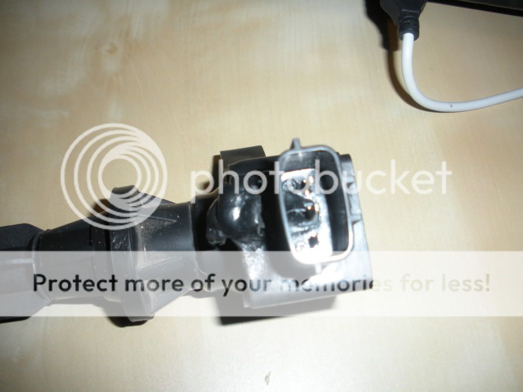

ok so i go and wash my car today and just gave it a little rince in the engine bay. well couple hours later i head off to work and the car won't start. the car ran great before today(mods in sig) any ideas or suggestions would be great.
so we try to push start it which starts it but then stalls. noticed smoke coming from the hood and my 4th coil is on fire. no water got into the spark plug hole
quickly unplug the connector. take out the coil and went and got another one.
well i plug the new coil in and the car starts but my fuel pressure is staying around 1500-1600 and bucking for about 15 seconds then just dies. quickly look at the plug and it had started to catch on fire. so much for getting another coil.
so i had it towed to a local shop and their going to look at it tomorrow. if it's major i'll have it towed back to my place and take mods off and then tow it to mazda. if they don't warranty it then mods will be sold to fund the repair cost since i'm in the middle of buying a house.
will keep the car til i can find something else to get which i'm very pissed because this car is my baby.
the first obvious thing i think that might have happened is something shorted out from the water.
the second might be that i fried something in the standback i'm guessing. can't really think of what else it could be.

looks like moisture caused an arc-over to me.

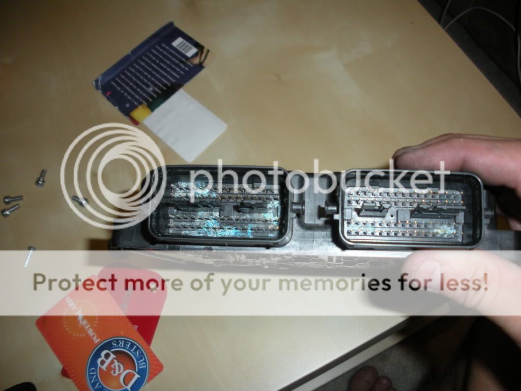

Check your ECU. Did you tape up or cover the wiring on the back of the PNP harness?
Check it quick as the pins on the ECU will rust quick and cause electrical issues.

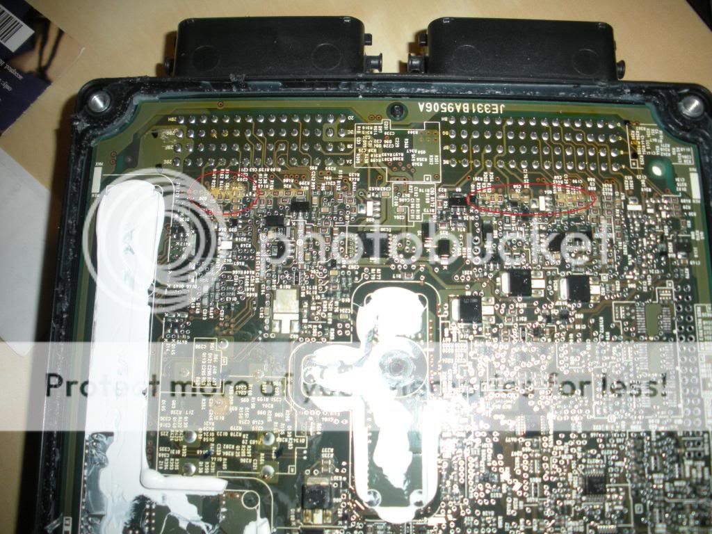

Check these threads:
http://www.mazdaspeedforums.org/foru...pnp-issue.html
and
http://www.mazdaspeedforums.org/foru...p-harness.html
good call on this. the ecu is indeed fried.......
before everyone calls me a dumbass the reason this didn't even come into play with getting this wet was my past cars(hondas, fords) the ecu is in the cabin.
i know these aren't cheap to replace from the dealer but are their any places i could get one cheaper?

well i decided to try the dealership today hoping for the best. they had first told me that all my mods on the car would not void it since this was an electrical problem. well after an hour of waiting they come back and say it wouldn't be coovered because it looked like the ecu wire had been tapped. it was my meth wire but had taken it off hoping they wouldn't notice but they did. they did not void the car warranty at all. they only denied the claim.
so he pulls my car in which started up and drove it in on only 3 cylinders. the service guy said it was going to be around 2-3k after said and done to fix everything and atleast 250 just to look at it!!! i told them hell no and asked for a towing company. so i got it towed to my place where it sits now.
i thought that if the ecu was fried the couldn't wouldn't start?? when the car starts the only thing that happens is the 4th coil starts to burn. i've got a new coil and new ecu on the way. is that all the else problems i will have to deal with?
here is a pic of the corrosion on the pins. which brings me to a pissed off point because fucking cpe decided not to make it seal tight from the pnp. dumbass's
so since i now i'm getting a new one i opened it up and saw more damage.
there are 2 red circles where it's at

Does the ecu have that fried electrical board smell? It doesn't appear to be black anywhere. Or is that water damage?

i know for a fact it's from water. no smell but the ecu is damaged.

Yep. Exactly what I got when I got water in mine. That blue residue is a dead give away.
I know only a couple others that have mentioned the issue with the PNP and water. CPE was looking into fixing the issue but under normal operation and not washing with pressure washer (engine bay or external) there should not be an issue.
I am glad I caught mine only a few short days after it happened. Plus it was in the winter and the water would freeze between drives and was only driving in town those few days.
I can't see it being 2K+ for the repairs 1K maybe for the ECU and reprogram. Not sure on the coil cost but shouldn't be more then a 200. I think they are looking at replacing the harness as well as the ECU and coil. I could be wrong.
