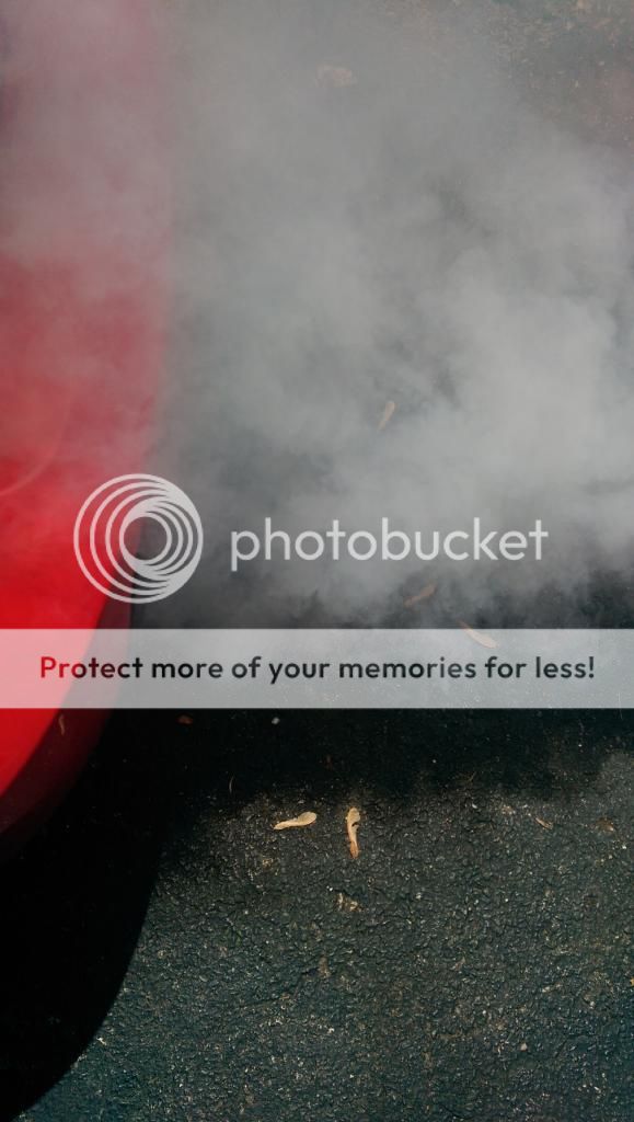

Well did this today and car feels smoother and idle is better. As far as cleaning the vavles??? I doubt it but ill enjoy the smoother ride

Okay I just used a can, and after the 3,500 RPM my car belched white smoke lol. So I guess it kinda removed some carbon build up? Or somehow this stuff blew my turbo lol.

White smoke doesn't = burnt intake deposits.

Turbo_Steve 06-14-2014 12:24 PM
So i finally got around to using the stuff. I will say that spraying it through the intake before the turbo is useless/pointless. It wouldn't draw it in well enough at all. It kept pooling and running out of my maf housing. So I decided to give it a try at the intake manifold. I used the port for the recirc/bov and that is the perfect spot for this IMO. I have a brass Tee in that hose for my boost gauge so I just stuck the straw in there and with the idle at 2k rpm let it go for 30 second intervals. I got smoke like I have never seen with seafoam before. I finished up the can and am letting the car sit as we speak. Will report back after driving it.
[IMG]http://i591.photobucket.com/albums/s...psc3853b1e.jpg[/IMG]
[IMG]http://i591.photobucket.com/albums/s...psf64b0029.jpg[/IMG]
Tokay444 06-14-2014 01:11 PM
Picks of valves?
Turbo_Steve 06-14-2014 01:39 PM
Ok, so this non scientific test has my initial stamp of approval. Ideally before and after pics of the valves would be taken. That is for someone else to do.
My impressions upon driving the car after the 1 hour wait time. Car initially felt worse. Drove a few block to a faster road, a little smoke from the tail pipe, but not bad. Chemical smell was present. Drove 10 mins at about 45-55 mph, came back to neighborhood streets for stop and go driving. Car deffinetly has smoother low throttle response but wasnt bad before. I did notice the little hick up the car made at idle every now and then isn't here anymore but a few more days driving will help figure this out.
I have 2,600 miles left till my next oil change. I will make this test more of a long term project now as I will run the cleaner again just before my next oil change(this makes 12,000 miles since I last pulled the manifold to clean the valves) and then I will pull the manifold and take some pictures of how the valves look.
I'm going to flat out say that this product won't replace doing a real valve cleaning if you have lots of miles on your motor. But it may be a good way to keep them clean if used every 3,000 - 6,000 miles. I think that if i pull the manifold after the second cleaning and the valves are gunked to shit then this stuff is a waste.
Will update probably late july when I get to the next oil change interval.
