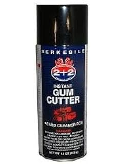

If you guys want a chem that cleans intake valves fast buy this stuff:
http://ecx.images-amazon.com/images/...SR240,320_.jpg
It's legit stuff. I cleaned some valves that I had out of an engine with it. 100k of carbon buildup gone in two wipes, it was removing stuff with one wipe that took me 10+ wipes with B12. This stuff is crazy strong, the whole can is warning labels and I definitely would advise to use it in a well ventilated area and to wear a mask. I don't know of any local places that sell it and I doubt any do but it can be had on amazon for ~$10 a can.
