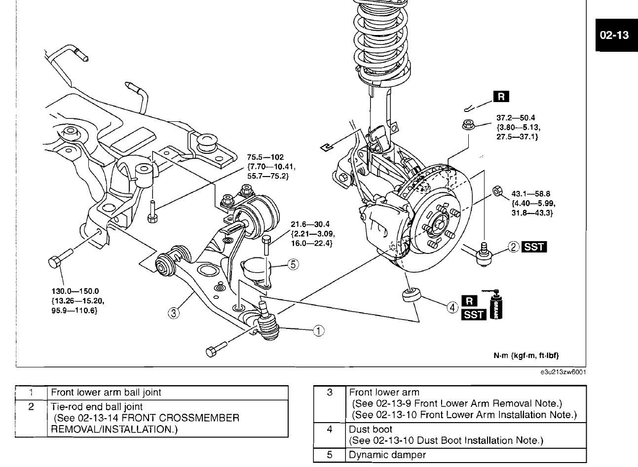

From experience...check your LCA bolts on the driver side and make sure they are tight. After my mount failed I began getting a clunking noise in the front when starting/stopping and going over bumps. It steadily got worse and I thought it was something related with the axle until I got a good look at the car. Only sound I get now is the forward/reverse click. I'm not sure if the bolt coming loose was related to the mount fail, but I never had this problem until that fateful night.
which ones now?

it's the farthest bolt on the left with 130.0 - 150.0 torque settings
