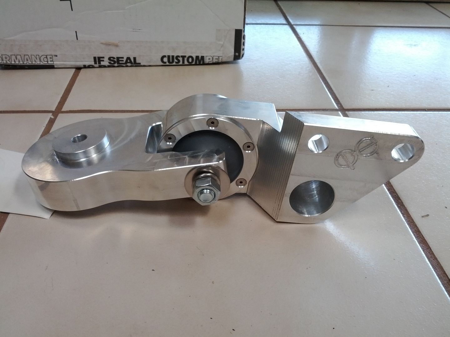

That picture I posed was their stage 1 mount. That bushing sits flat face down inside the subframe, and when you punch it, all of the stress is placed on the face of that bushing, which is what causes them to fail. That's the same reason the stock one is garbage. If you grab your stock mount, you can probably push the center of your bushing out by hand.
A stage 2 looks like:
http://i55.photobucket.com/albums/g1...310_122112.jpg
The stock bushing location is now a solid chunk of metal, and your bushing is not turned vertically. Meaning, when the stress is put on the bushing it pushes the bushing into its frame, so it can no longer tear and push itself out of the frame of the mount.
If that makes any sense.... Its the difference of pulling and pushing the bushing up and down, versus pushing on the face of the bushing itself.

I might play a bit of a devils advocate for a minute here as I just replaced my Stage 2 RMM after 4 years as the bushing had developed a tear. It was nice to have a compliant vibration-free mount, but the engine was moving as much as the OEM mount by the time I replaced it.
I asked CP-e if I could just buy a replacement bushing but they weren't much help so I just bought a whole new (Stage 1) one.
This gives me quite a history of rear engine mounts over the last 7 years.
OEM - Corksport Inserts (IMO, highly underrated) - SURE REM (Replaced after all the failures that happened, mine was fine) - CP-e Stage 2 (Bushing failed) - CP-e Stage 1 55 duro (Installed yesterday)
I have now swapped back to a stage 1 RMM for a couple of reasons. Mainly, after I installed the stage 2 RMM I found my car started popping out of 4th gear under heavy downhill braking at the racetrack. This also coincided with a switch to semi slick tyres so I never genuinely had a chance to prove that this was the cause, but my mechanic made a good point that since the bushing orientation had changed, it may have altered the way the entire engine moves on its mounts. The design may seem to make much more sense on paper, but there are reasons why the manufacturers do things the way they do.
I know it's an unproven theory but it resonated with me. And now that I am back running a S1, we will be able to test this theory properly real soon.
Here is a video of what happens when you pop out of 4th gear and have no power to pick up the weight transfer on corner exit. Just watch the gearstick.
https://www.youtube.com/watch?v=QtDV7yhr2Qw
Also here are some pics of my Stage 2 RMM that I just pulled off my car. Bought it in 2013, it's done 60 000km and about 25 track days. It's served me well but I am happy to go back to the way the gods (designers) intended. This design is sold on the premise that the bushing will last forever but that's clearly not the case. So if I am gonna be replacing parts, I would rather keep it cheaper.
http://i.imgur.com/wtmdIjAh.jpg
http://i.imgur.com/MWpHhvIh.jpg

Thanks for the reply, it seems you experienced exactly what I was in that it seemed like there was no difference in engine play. Do you have the other mounts upgraded or just this one? I do like the idea of the S2 and it makes a lot of sense to have it over the OEM one but the full benefit isn't happening for me. I don't track/autox this car yet because it's my only car but I'd like to get out there. I was expecting a lot more from this mount. I've read the inserts have a lot of vibration and I really didn't want that since I have to drive this every day.
Reedy 08-13-2017 09:17 AM
It's an engine mount. I don't know what you want from it exactly but it was never going to change the world. All aftermarket ones cause vibrations but they also settle down with time as the mount beds in. I just have the rear one rest are oem.
