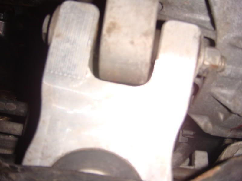

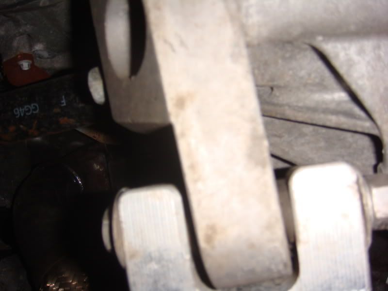

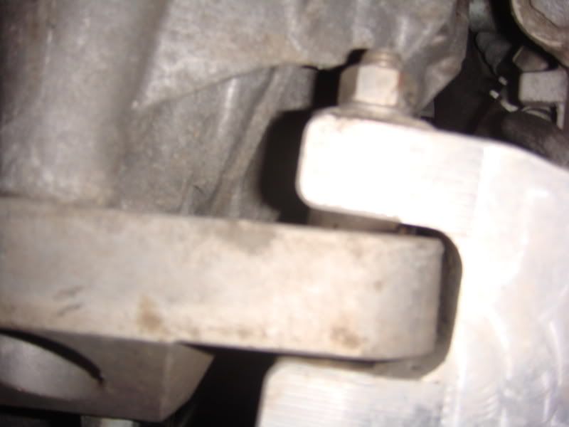

the darkstar tranny mount cocks my cpe rear mount to the side, i need cpe mounts for the front two asap, i think the engine being not in the exact spot is the casue of alot of the vibrations
darkstarmotorsports 03-20-2009 01:28 PM
First of all, it's Medieval's tranny mount, not Darkstar's.
Can could provide a pic of you CPE rear mount sitting cocked to one side?
bf360 03-20-2009 01:40 PM
ok my bad, and yea one second

Bio, you can center the motor if you have the time to do this. You need to loosen both the pass and drivers side mounts, then loosen the middle mount (rear center mount). Move the motor left or right to get to the proper possition, and wallah your golden. Tighten down the fixed lower mount bolts (frame bolts) then tighten down the mount to braket bolts. We have had a few that had shifted pass side mounts due to the excessive movement from the stock mounts. This will get the center mount more straight on and seems to fix a little bit of the vibes from the motor.
Adam is so pro 04-17-2009 06:29 AM
So the cocked rear mount (being that it's aftermarket of course) can just be loosened and then retorqued?
darkstarmotorsports 04-17-2009 07:59 AM
Loosened and re corrected, yes......
