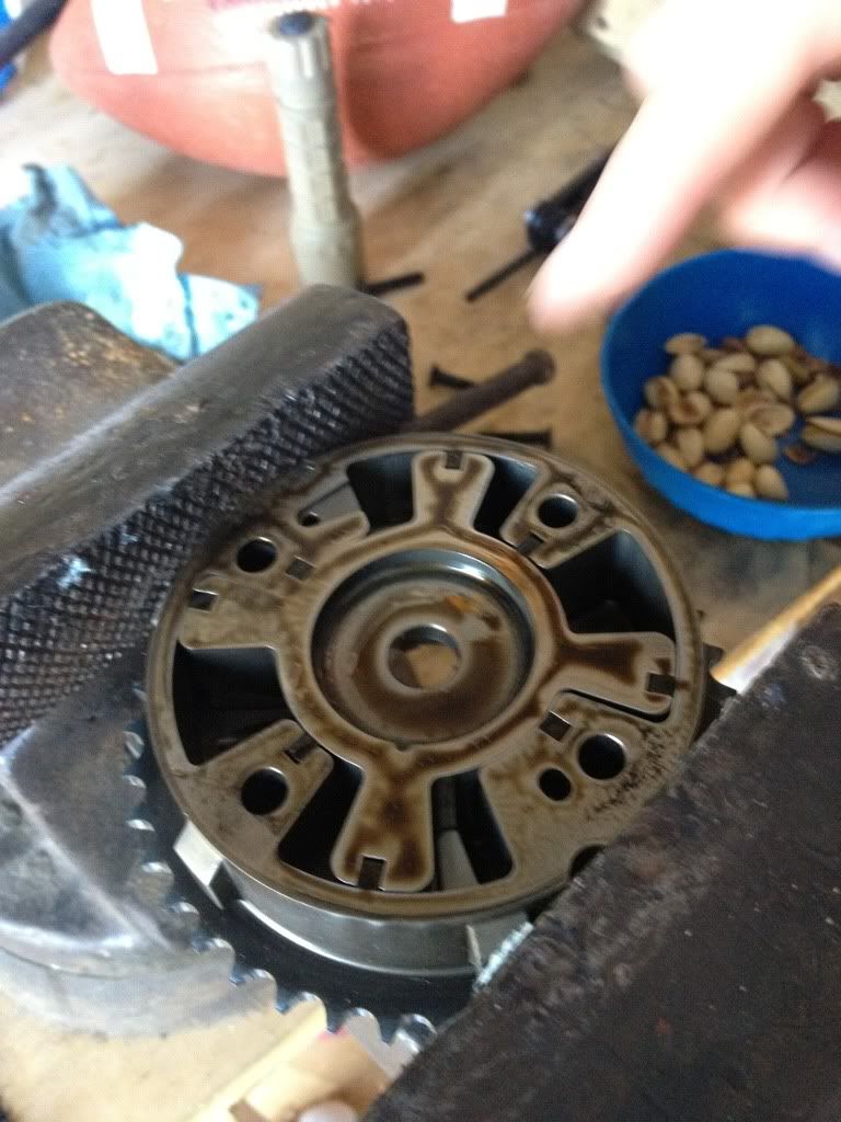

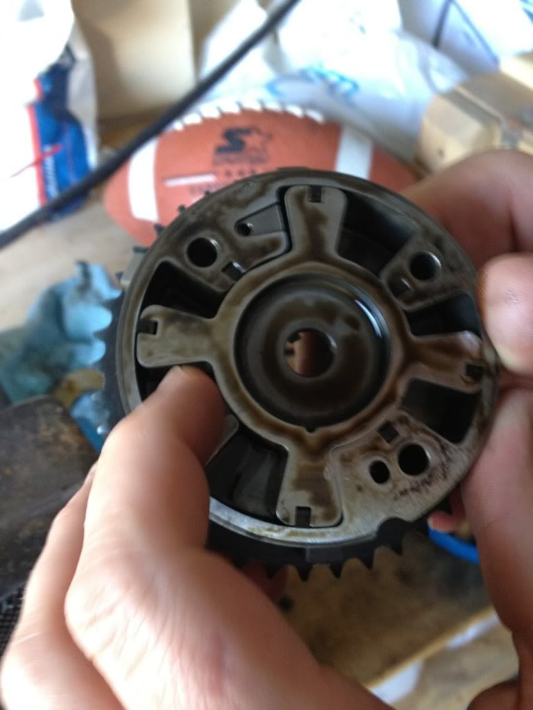

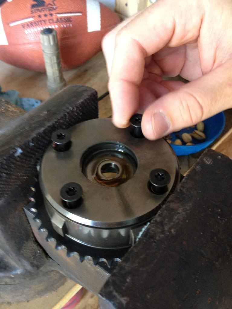

Some pics of the broken vvt actuator (wanted to take one apart for a while now)
http://i359.photobucket.com/albums/o...n/0c086b6b.jpg
http://i359.photobucket.com/albums/o...n/f7226ad0.jpg
http://i359.photobucket.com/albums/o...n/8576522d.jpg
And a lil vid of us rotating the center section:
VVT - YouTube
Surprisingly simple i guess, just 4 oil chambers, 2 pushing to advance, and 2 pushing to retard, and the oil control valve simply adjusts the flow. My question is the purpose of the pin... i should have taken a pic of how this unit was broken... but what exactly does the pin do? Just lock the actuator when there's no oil pressure? Is it spring loaded, and disengaged when oil pressure is present?
And if it's only used when oil pressure isn't present, then it's really only used on start up... and in that situation, it really doesn't matter how much power your actually making. So am i right in thinking these VVT failures have no correlation with power? I mean shit, my ms6 VVT is still stock, and it's making pretty decent power. I can see how stiffer valve springs would have a direct effect on failure, but not necessarily "power".
If anyone cares to share, i'm all ears :)
Tokay444 06-26-2012 05:10 PM
The purpose if the pin is to keep the cam phase at ideal idle/start up avdvance for when there is no oil pressure at the OCV spool.
So really, a broken vvt worst case scenario, is that button gets sucked up by the oil pump.
There is no hampering on power.
Bad vvts have nothing to do with stretched chains as the common misconception leads people to believe.
