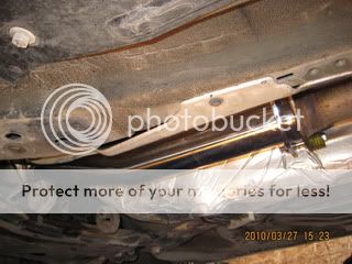

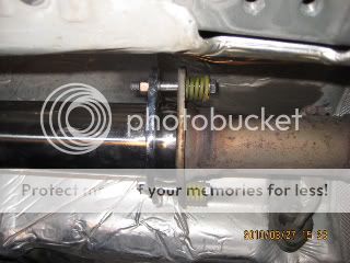

Installed my Ebay testpipe yesterday...got mine for $108 but it looks like the sellor has raised prices to $124. Still worth the higher price IMO but it is getting close to the brand name stuff.
Fit perfectly and looks exactly as the Ebay pics. I love SU and CS stuff but for a "pipe" that's gonna sit under my car and never be seen, I'm ok with a no-name so long as it fit which it did. The quality was great - welds were nice and so was the material. Had a nice weight to it and didn't feel cheap. The ebay pipe has a loose flange on the CBE end so alignment is easy...i can picture pipes with two welded flanges having issues if they are not made perfect.
Came with a gasket (for the DP end) which i didn't use. The CBE end does not require a gasket. Also came with 3/8"x3" long bolts, nuts and washer which I also didn't use..I bought stainless hardware at the local hardware store.
Here are some pics of it installed for people who have reservations about the ebay product...
Entire pipe (front of car is left of pic)
DP end
CBE end

noone is having any rattling issues?

So far so good for me...but I've only had it for a day (or 30 miles). My test pipe was an ebay one but I followed instructions from another manufacturer which said to tighten the bolts until you have about 1 mm in the gaps of the coils of the spring...I did this for the CBE end but the DP end was hard to see the spring gaps.
I think guys who tighten the shit out of both sides may have rattling issues.

Well I was wrong...while idling at the drive through this morning, I noticed that I did have a slight rattle.
I can hear it most when I'm in the car at the drive through with the window open. I can also hear it slightly when I'm outside my car with my ear around the front driver side tire.
Its not that bad but I will probably get under the car after work and loosen the DP end by a turns or so.
