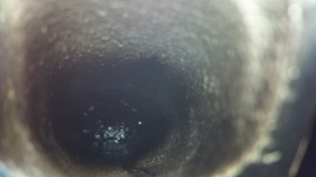

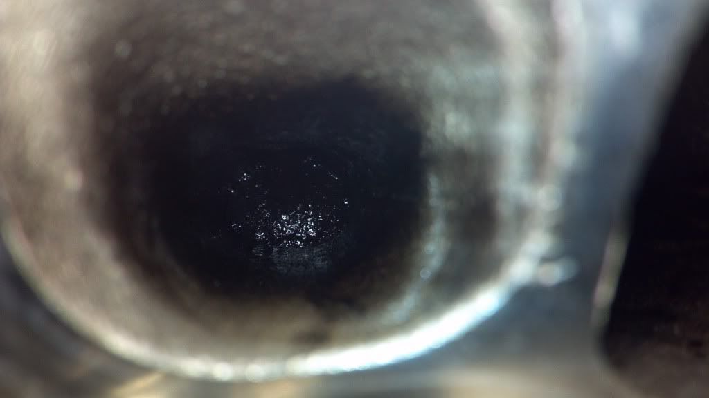

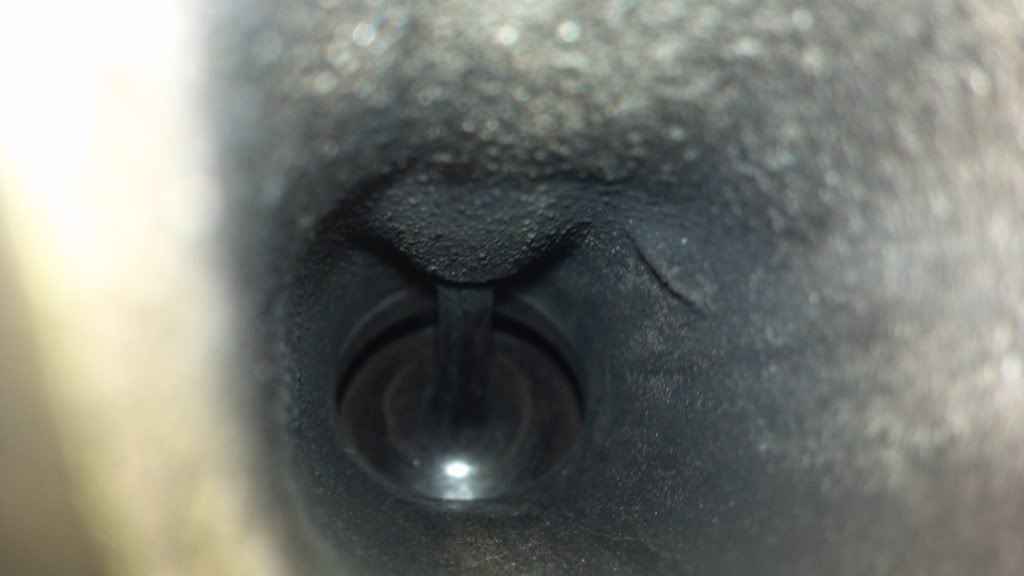

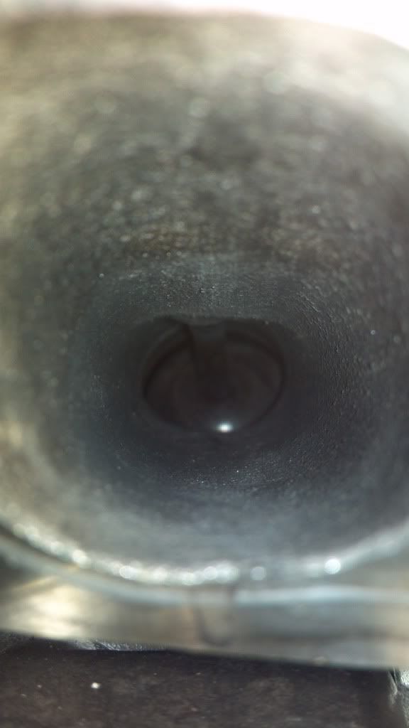

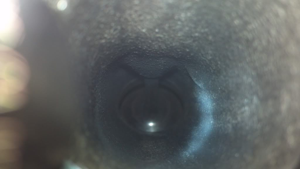

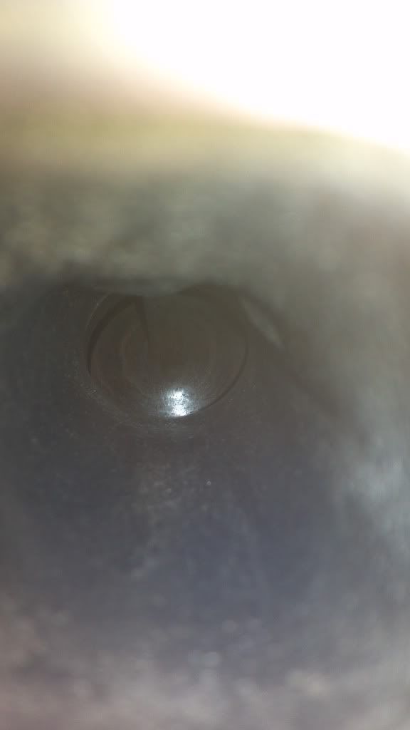

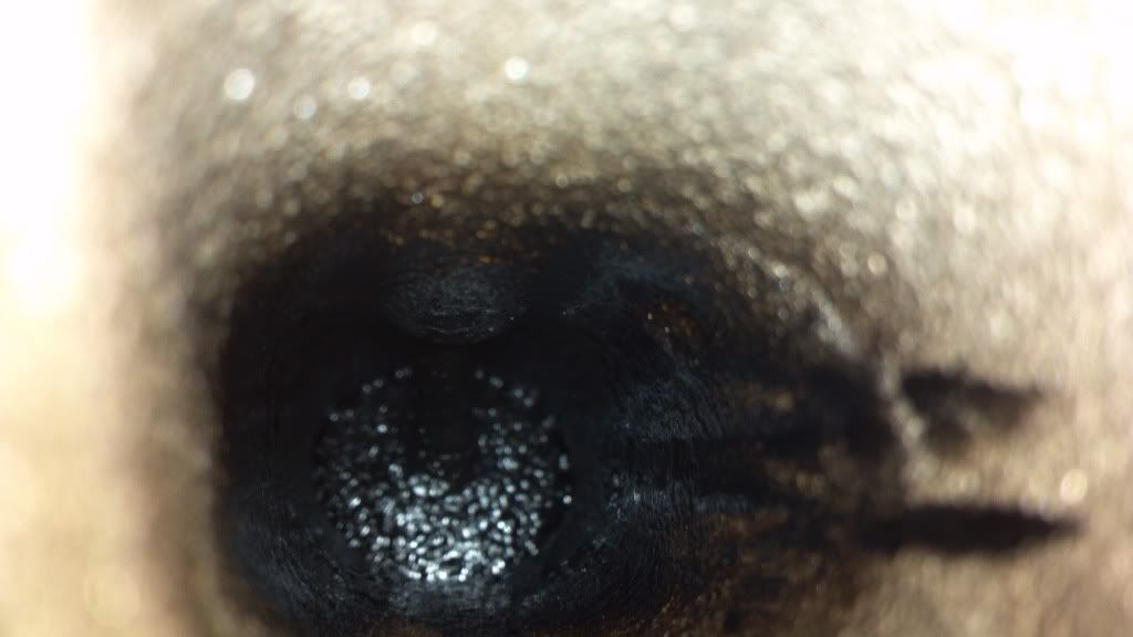

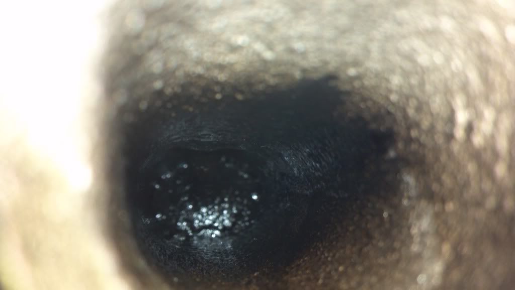

Dirty Valves Were Dirty
59k on the clock...
First cleaning, ever..
I know its been said hundreds of times, but holy mother of god what a night and day difference...Engine is so responsive now. Rev's work up so much faster, extremely responsive, have to basically learn to drive the car again with how responsive its become. A good amount of power to be made back thats for sure. So this is a reminder, keep your valves clean !!
ohh and its fasttttttt !!
A couple before & after pics

theurgy 11-04-2012 12:34 AM
What procedure did you use to clean it all up?

ms3blackmica 11-04-2012 12:36 AM
B12 chemtool, picks, and some other various tools from the random tools drawer. Flat hades seemed to work best for the inital scraping of the heavy layered gunk. Then shop vaccing and blasting with compressed air. Not as bad as you'd think you just have to be aggressive and go to town on them.
I will deff. be investing in a media blaster though for the next time around.

ms3blackmica 11-05-2012 11:26 PM
Originally Posted by Ms3_Miami (Post 1727608)
My car is at 52k and god they are gunked up. I did an EGR delete like a month ago and still havent installed an OCC.
I dont have a compressor atm but Im gonna try your method since it gave you great results. Thanks
Yeah i did the EGR block off around 45k (i think) miles..I now have 59k.
If you wanna know what I did in regards to cleaning...I removed the valve cover so i could see the position of the cam lobes to ensure 100% valve closure. Once i knew the valves were certainlly closed, I went ahead and poured some B12 in there.
1. Used a long flat head screwdriver to scrape the gunk off.
2. Shop Vac it up, Spray compressed air (My tank was at 150 psi), pour more B12..
3. Scrape again (dont forget to clean the stems)
4. Shop Vac it up, Spray compressed air, pour more B12..
5. Once all the main gunk is off, I used various picks to the scrape and pick off remaining carbon buildup (with B12 in there while picking).
The compressed air helps a LOT.
