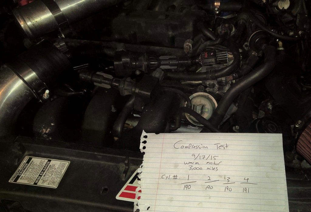

sho 09-23-2015 06:35 PM
Stock motor at 145k miles. I retired it at 161.5k and it had seen 22psi from a 5858 from 124k to the day it was pulled out. (still ran great)http://i1298.photobucket.com/albums/...psdbnybyp4.jpg
Built motor at 3k miles
http://i1298.photobucket.com/albums/...psjpwzrnhv.jpg
