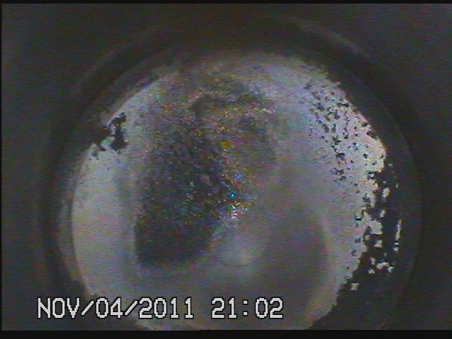

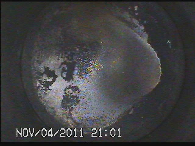

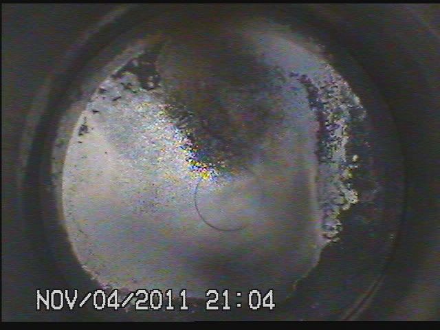

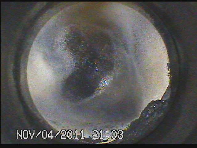

Tomas 11-05-2011 08:02 AM
2009 MS3
40K miles - spraying meth for about 20K
Ambient Temp about 68 deg.
Sealevel
185
185
185
190
Hey Lex,
What do you say about the marks on the piston crowns. Are those from the Injectors spraying? I am assuming this is normal for DI engines. Looks a little as if there was brass on the crowns. The blots are sort of golden looking. Spark Plugs look perfect.
Boroscope pics:
http://i1211.photobucket.com/albums/...t/IV7L0002.jpg
http://i1211.photobucket.com/albums/...t/IV7L0004.jpg
http://i1211.photobucket.com/albums/...t/IV7L0005.jpg
http://i1211.photobucket.com/albums/...t/IV7L0006.jpg

I'm so late to this party but the spray pattern from teh injector just cleans the carbon from the crowns so you're seeing that triangular shape - in the first pic especially. Any shiny stuff is generally not so hot - it can be pitting from detonation or just an unclear image. The crowns are very clean however.
