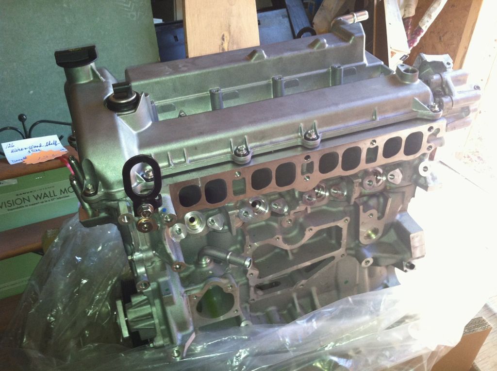

Tokay444 01-18-2012 04:56 PM
It was built.
It was beast, and it was $5200 built.
Not 2600 because I'm and idiot. And it was months ago.

hahah I was going to say there was some smuck trying to sell an OE longblock on here for 2600. now that waaay too much for a used disi but I would buy a dozen built motors if they were 2600 :)

Jh8909 08-30-2012 09:36 AM
Did mine last night. Uh oh
(passenger)
175
150

Lex 08-30-2012 09:48 AM
(passenger)
175
150
125
175
(driver)
Looks like time to source a new motor!
Did you crank it until the needle stopped rising?
Jh8909 08-30-2012 09:51 AM
Yep, even checked cylinder #3 twice. Consistent 125

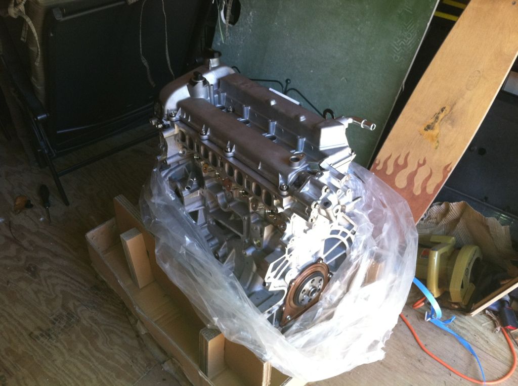

Jh8909 10-19-2012 02:30 PM
Originally Posted by himurax13 (Post 1698213)
Any update on this?
Yep.
http://i737.photobucket.com/albums/x...2CC240057B.jpg
http://i737.photobucket.com/albums/x...2CCC6C1D93.jpg
phate 10-19-2012 02:46 PM
[QUOTE=Jh8909;1698256]Yep.
Brand spankin new from Mazda? I recognize that box lol.
Jh8909 10-19-2012 03:19 PM
[quote=phate;1698287]
Originally Posted by Jh8909 (Post 1698256)
Yep.
Yep. Just tested to see if it works. Its got 3 miles on it. Got it for a steal. You don't wanna know how much lol
phate 10-19-2012 03:44 PM
[quote=Jh8909;1698334]
You're doing well if it was under $3500 or so ;)
New shit runs SOOO well, lol. Have fun with it!
