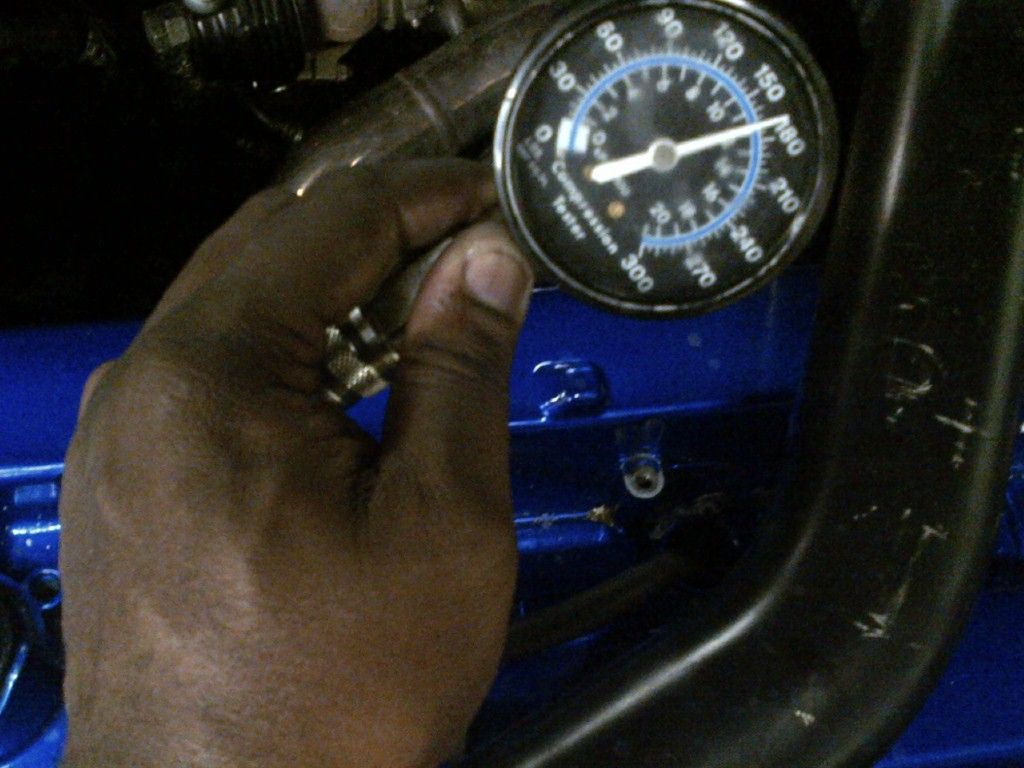

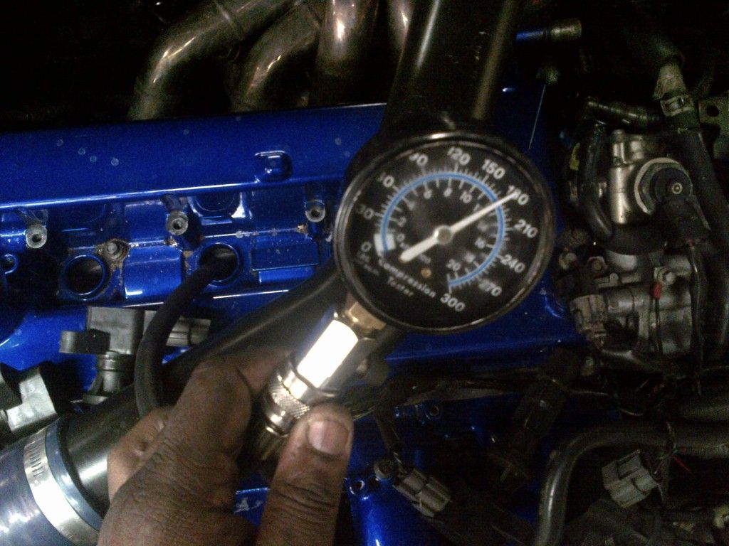

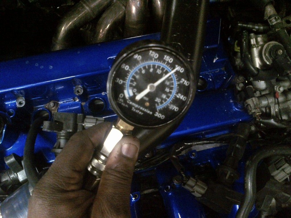

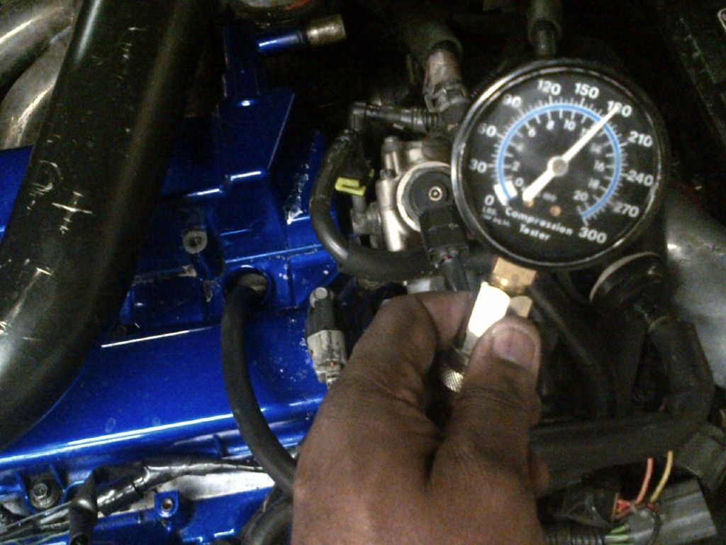

So i just broke 50,000 on my built motor and i did a compression test last night here are the results..
180
170
180
180
track weight 3220
street weight 3370
fully built motor//carrilo rods//cp pistons//ACT 6 puck//all mounts//gt3582 turbo//CPE manifold//ported intake//h&r coils//brembo brakes//tr10 I/C//accessport

 Old 03-26-2013, 03:59 PM   #498
Originally Posted by alphasaur View Post
180 180 150 180
cranked 3rd alot with hopes and dreams.
Oil in the intake?

180 180 150 180
sorry to hear man..although not definitely a ringland at this point. I would check piston height next.
alphasaur (03-26-2013), Easter Bunny (03-28-2013)
Yessir.
What is your oil consumption?
I don't really go through much, MAYBE half a quart every oil change (I do 3-4k miles rotella t6)
Don't have any clutch pedal vibes if you're alluding to a bent rod. Will do a height check though.
yeah it looks eerily like my compression results and mine ended up being a ringland. No idea what a slightly bent rod would look like as far as compression results go nor if it would cause vibes.
But you can drive indefinitely on a cracked ringland but NOT with a bent rod...IMO at least, so it's good to rule the rod out.

I cranked over the engine about 10-11 revolutions...
Compression check results:
Driver side to Passenger side (I forget the numerical order)
182-176-174-177
4.5% delta between max/min. I can live with that at ~500whp.
I love these motors...
