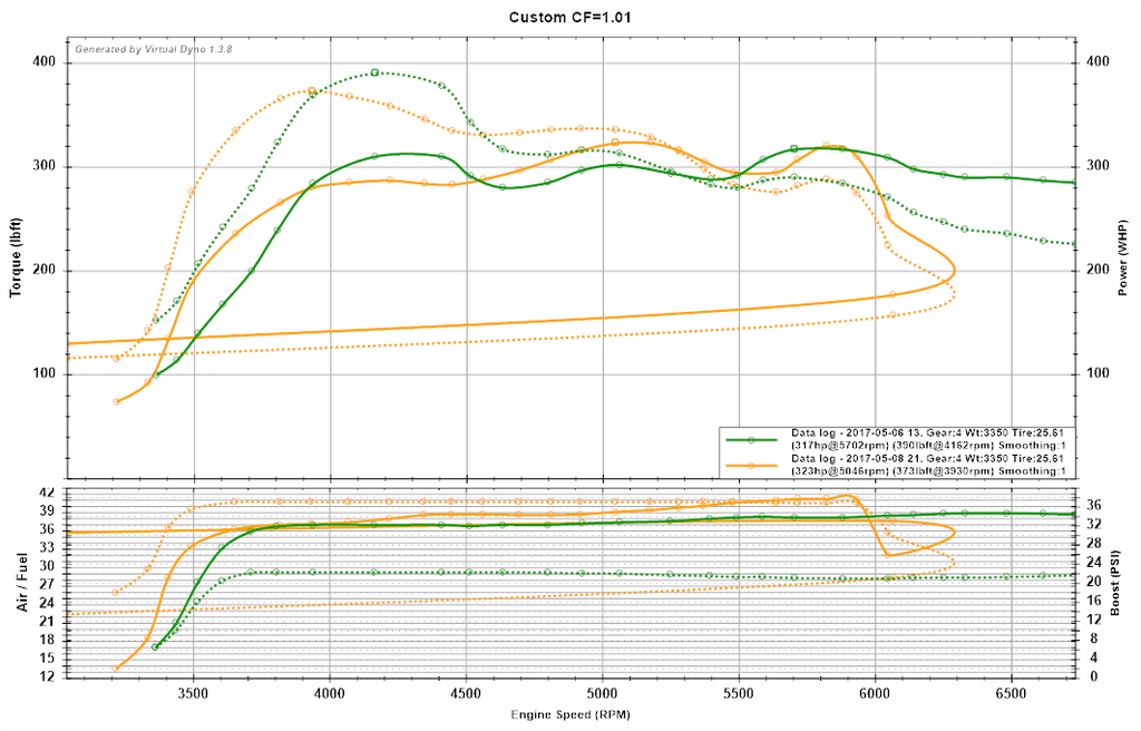

@Carskick; No one is going to spoonfeed you technical knowledge or write a novel in a forum about the differences between restricting/unrestricting the compressor and/or turbine side of the turbo. If you are really interested- do more reading on the profusion K04 bolt-on builds and pick up some technical books and white papers, such as "maximum boost" by corky bell (VIP vault, I think) and the EFR training manual.
I can tell you that nearly completely unrestricting the compressor side of my modified K04 with a bar&plate 3.25" TMIC, 4" intake and low ethanol mix (~e30) has hit a flow wall with the two stock cats. Below are two logs from tonight, pushing 41-42lb/min and only seeing low 300's at the wheels. I can speak from experience, that the unmodified K04 with only a 4" intake (stock 2 cats and stock intercooler) spools stupidly fast- coming from someone appreciates response in AX racing.
If you don't have high HP power goals, then throw a big intake on the K04 and call it done- the downpipe question is irrelevant.

Nor do I want to be spoon-fed. I've been spending a lot of time trying to find the right information to make my decisions. But getting different opinions doesn't hurt.
So to your point... The intake is the biggest thing that improves spool time for the K04. That will be done, in fact, I already have my 3.0" JBR WP ready to install once I get my AP and any other parts.
At this time, I'm looking at mods that add power throughout the band while maintaining reliability. A little more aggressive noise is good, but don't want to be excessive...
According to CS' dynos, the downpipe added torque throughout the entire power band, and the power seems smoother. Plus a little bit meaner exhaust without too much is appealing. That's another reason to keep a Cat for me, as it quiets things down a bit.
And compared to the CS setup, I'm looking at a larger intake and a larger TMIC. So wouldn't I really be hitting the limits of stock DP? This is why I was planning on this upgrade.
