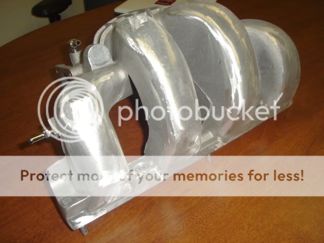

So while I have my dnp manifold off getting ceramic coated I decided to tackle some mods to my intake manifold. Wasnt quite sure what I was gonna do exactly but figured once it was off I could come up with a game plan. Man I was not pumped about how hard this thing was to get off. REally not fun at all, but after an hour I had it off.
So my car has roughly 4k on my new motor. Pretty much brand new still, but to my suprise there was alot of oil in the manifold and on my valves. Fuck!!! I have an egr delete to but apparently I need a catch can also. I guess Ill add that this go around. Should only be a few days before back on the car. This is all part of my plan to hit my goal of 400whp with a atp3071r, hopefully on pump 20-22psi. I know alot of you guys will say its not possible but I seem to have a nack of proving people wrong, LOL. I dont think this goal is a far stretch and I guess "we will see". Im not gonna dyno at 14 dynoes to prove my point either lol.
Here are a few pics to start. Ill post more soon.

So here is what I did. I pulled the flaps and bar out. I cut the bar right at the inlet side so that it could still plug the hole so no welding was needed. I removed the last runners hump and mildly ported out all ports to match gasket. Some runners needed more work than others. I also took out a good amount of material where the tb is to match it all up nice. Ill post pics later tonite. I think its gonna definately give me some gains. Just taking bar and plates out would be noticable im sure.

driver311 12-12-2010 09:16 PM
5 Attachment(s)
Here are some updated pics of the work I did tonight. Let me know what you think. The only thing I didnt take a pic of is the port where the black box goes on top. I tapped it for another boost source. That way i can use it for a bc source and the other for my bov.

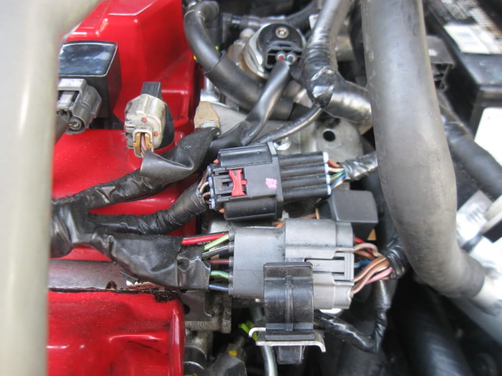

driver311 12-14-2010 08:32 PM
Originally Posted by rigor (Post 652460)
so what is the black box on the top of the mani ?
and did you leave the linkage in the one end, to keep from getting the code? or are you welding up the holes?
Yes I cut the rod and left the sensor plugged in. On the box i just removed it and put the sensor under the intake mani plugged in still. Im sure itll be just fine. With all that crap removed and light porting I think its gonna work pretty slick. If I got 10whp Id be really pumped. We will see.

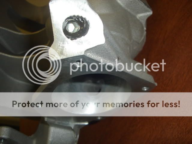

Heres some pics of the new port I tapped into the intake manifold and how it looks with the black box gone. so much better.
