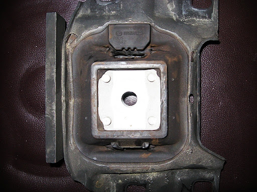

here's mine:
http://lh3.ggpht.com/_GsVhq-_dRXQ/TD...jul07-pic1.jpg
P5_2_MS3 07-08-2010 01:35 AM
Originally Posted by dizzin9 (Post 572436)
here's mine:
Failed or failing? Seems like the wear and tear on these things is really accelerated.
