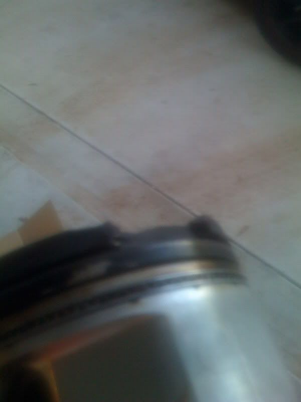

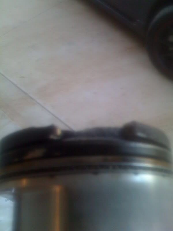

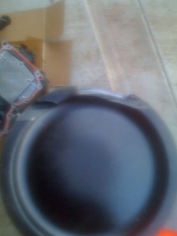

Phil agrees, the black ride is cursed. I give up. Many of you know i had some problems about a month ago. I had a shop throw in a used motor and the car is running top notch. it also looks nice now that i've got my roof rack and new wheels on.
i tore apart the forged, built motor and this is what i found.
excuse the blurryness. the iphone doesn't like my oily hands.
the arias piston took a dump in the middle of a 10 hour road trip... randomly. the chunk put a hole in one of the exhaust valves. fortunately, the block is still in great condition and the head is very usable with a new valve.
i don't know how, why, or what happened. i never heard anything, just drinking tons of oil at one point. now it all makes sense.

any chance you had a valve float and hit the piston? Is the valve bent at all...

valves not bent at all. all of the valves are perfect condition. i think the only reason there is a hole in the valve is because the chunk that severed off actually left a part of the piston 'lifted' and 'raised' up, which knocked continuously banged the valve at tdc.

fucken bullshit...how does a forged piston crack like that

outta curiousity do you ever watch your egt's?
when I was dealing with hiboost they royally screwed something up and my pistons where completely chewed on top...not cracked like that though...just looked like a puppy had nawed the outside face of the wiseco pistons
none the less a forged piston should not have that happen

yes, i've had an EGT gauge for about 10 months now, BEFORE the motor was even built.
i've had egt, oil pressure, boost, and aem wideband for quite a while... its all a mystery.

stock pistons ftw. funny thing is I've seen that happen to stock cobalt ss/sc pistons. there nortorious for chipimg like that

if someone is going forged, CP has my vote. thats probably a rash decision based on emotion, but BLAH! this is lame.
also, since I suppose this is one of the first built motors to be pulled, i WOULD recommend getting the skirts coated, you can see the surface wear on these pistons where they've been tapping the sides of the cylinder walls.
yes phil - get some H-beam forged rods with the stock pistons and feel good about 420ish whp capabilities, if the hypereutectic pistons will do it.

like i said on the phone, and its critically important here and should not be ignored before we dump on Arias here - if the rings were not gapped right, and they were too close and bound up, that is exactly what is going to happen to a piston regardless of its made of jello or aluminum. so before we all get scared shitless and looking for pieces of the sky to fall, there is plenty to consider here. now that i am actually seeing a picture of what we were talking about, i am all the more convinced that its a likely possibility.
like i said on the phone earlier - i would call the machine shop and asked them what they gapped the rings to. Arias has thier own spec for that. Mazda has thier own spec for that. If you are on an extended trip, where the engine is nice and hot, and that ring expands, end gap touches to the point where it binds up, the force is going to travel somewhere and pressure will be exerted somewhere. I have CP pistons in one of my own car where I personally failed to gap the rings. And it came out looking just like that.
The mantra that its ok to gap rings too much is really really true. I'd rather burn a bit of oil than run tight gap on an engine where I know I'm going to be boosting on it, beating on it, making it hotter than Hades or even just taking trips on it. A little oil burn can be dealt with. Cracked ringlands in pistons cannot.
i'm not trying to come across like an asshole here, but it seems alot easier to trash a part from one photograph than it does to truly assess the situation from every angle. and that is neither a logical approach, a fair approach nor is it one that really does the progress of the community any bit of justice. i know what we gap our rings to and set our cylinder wall tolerances to, and i have yet to see a short block we've built with this setup come back like that. its very important to know if, frankly, your machine shop fucked you over. either with ring gap, an improper hone, or just poor measurements. i don't believe in curses. i do believe in human error.
furthermore besides the point, if it could be determined that the piston was faulty, i guarantee you Arias would take care of you, if you were to go that route.

The top ring gap could definitely be a cause, but to cause a failure like that it would have to be way off. I don't know what those pistons call for, but if ring expansion caused that I would be tempted to say that there was no gap at all. The ring would have to expand to fill any gap and then keep expanding to deformation and press itself against the top and bottom of the groove with enough force to break the ring land off. Epic fail.
A ring that causes that type of failure is going to score the bore and generate enough heat to burn itself, if there isn't any scoring I would be tempted to look somewhere else for a cause.
You should consider sending it in to Arias to see what they say about it.

Looks like a weak piston to me... either the material recipe was off when it left the factory or there was a shit ton of detonation. I would go with the material in the piston as the cause.
Ive seen rings fail and never have they blown a chunk off the piston like that. Ive even ran an engine at 16 psi of boost, cracked ringlands, 100 shot of nitrous, for 8500 miles and the piston was still usable, although i changed them out.
I dunno man, you were cursed from the get go, is what im believing.
no one is saying the ring failed. i am saying the rings were not gapped enough. i have seen rings bind up and shatter a piston entirely. when you have pressure like that, from expanding steel as thick as a ring, build up then bind up in several directions at thousands of rpm, i don't care what a piston is made of, its going to break. that it broke just above the ring land with the thickest piston ring should give cause to at least consider it. i've showed this picture to more than a few 'experts' if you will without even telling them the story or what happened to the engine and that was the first thought out of thier mouths collectively.
that said, and like i told jon, if he wants me to go to Arias and back him up and fight on the side of having a bum piston, believe me i will do it for him regardless of what i personally feel or think. at least then, if he gets a free set of pistons out of the deal, he can sell them and recoup some of the pain and cost in doing so.

I never said anything about a ring failure, but a ring gap problem should leave a score in the bore and that has not been noted. Until I see some type of bore damage I am not inclined to think that it is a ring gap problem.
Detonation can do that type of damage and god knows we have detonation on this engine.
