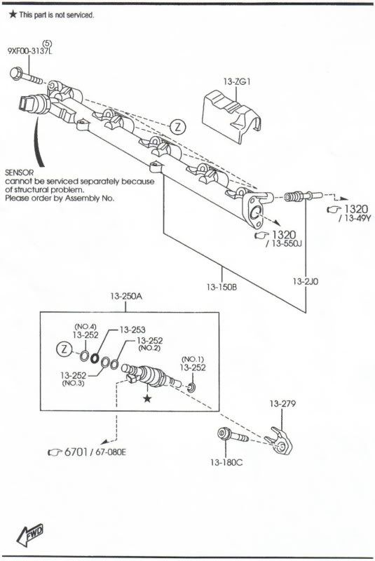

 Old 11-26-2008, 09:43 AM   #59
whoosh@Realtune's Avatar
Location: PA
Posts: 1,459   (View Stats)
Rep Power: 1820
Thanks: 1,082
How'd you fix the injector issue new seals?
just to add
I actually encountered an issue when swapping injectors
keep this diagram for future use
each injector has 5 seals
1 between the head and inj
4 between the inj top and rail
I had an issue with the seals between the head and injector
they have a concave shape and must be installed rounded part toward the injector
if you have a bad ring seal and need replacements, they are about $30 each from the stealer
if you want to completely o-ring your injectors with new parts, it will cost you near $240.00

 Old 11-26-2008, 10:00 AM   #60
Fux Wit It
Darksun280's Avatar
Location: Li
Posts: 9,214   (View Stats)
Thanks: 7,795
Groans: 175
Originally Posted by whoosh View Post
just to add
Probably going to copy and stick your post. We need a parts database with part numbers
