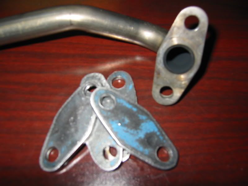

whoosh@Realtune 06-20-2009 05:23 PM
I made the first one and still make them for members
I lost count but have made near 100 of them since 2007
PM me if you want one
http://i131.photobucket.com/albums/p..._/IMG_2227.jpg

dane, here's a pic from aaron's thread on where the 1/2 plug goes
http://i165.photobucket.com/albums/u...4485Medium.jpg
whoosh@Realtune 06-26-2009 07:26 PM
Originally Posted by phaillyb (Post 255529)
there were typed instructions...yeah...
maybe ron noticed who was dealing with and didn't give me any benefits of the doubt. lol, thanks whoosh.
I was bored and made instructions the other day lol
all kits come with them now
the plug on the IM side should be temp
the right way to do it is hack off that entire EGR leg / tap and plug the hole or weld it shut (I have done both to members intakes)
