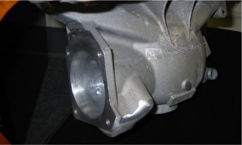

the plug on the IM side should be temp
the right way to do it is hack off that entire EGR leg / tap and plug the hole or weld it shut (I have done both to members intakes)

here is a quick pic of Deadman's intake
the EGR leg is hacked and welded shut
best way IMO
