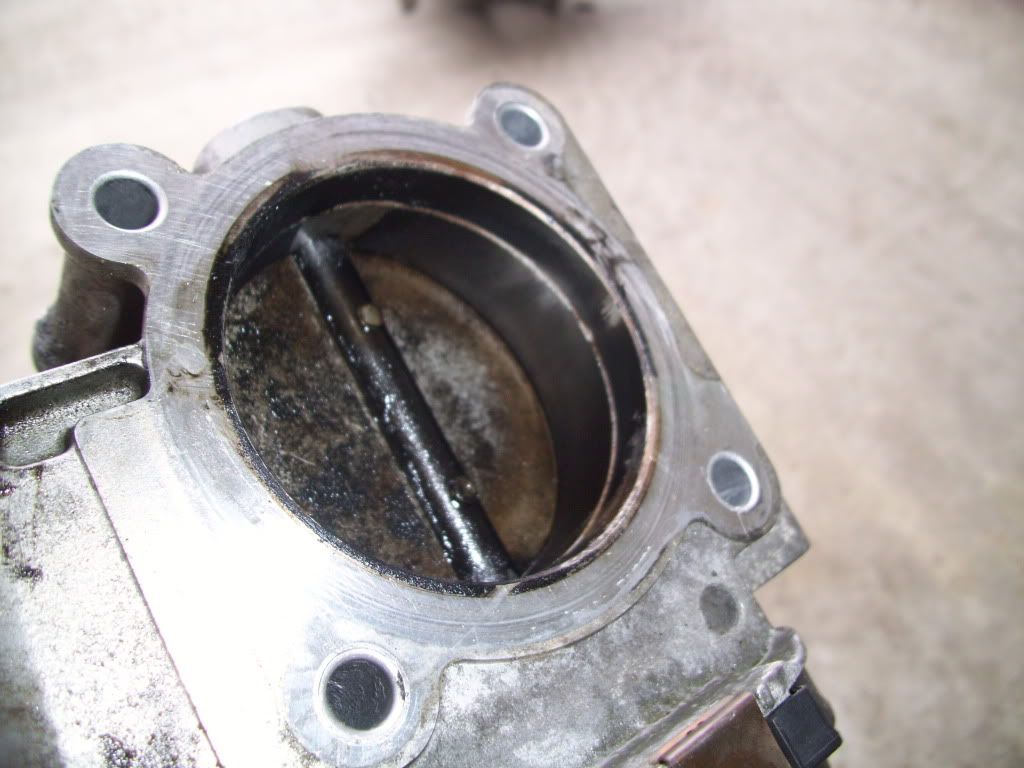

I have the PT-P EGR delete that comes with their I/M spacer. It's simply a plug that presses into the EGR tube. I've drilled a pin size hole in the plug, just to avoid CELs.
I had been running an OCC for quite some time before I did the EGR delete, and there was no pool of oil in my I/M anymore, just a bunch of funk contamination from the EGR, and pre-occ PCV gunk, so I properly cleaned it up.
The back side of the TB:
Edit: If you're not planning on getting the PT-P I/M spacer, I'd recommend whoosh's EGR block off plate. Send him a PM

 Old 02-14-2010, 03:25 AM   #39
I have candy in my van
MATT DAMOND's Avatar
Posts: 1,931   (View Stats)
iTrader: (18)
Rep Power: 2810
Thanks: 4,091
Originally Posted by tvissues View Post
Nah i'm talking about the block off plate. there'd be no leak, its just allows the EGR to partially work.
Then it would just VTA, you need it to be read by the MAP sensor or w/e to not trip a cel.
I've installed a bung in my EGR tube and drilled a tiny hole in it. Basically my EGR is restricted... very restricted. So no CEL, and my mani is this clean:
Compare that to my pics in the earlier post, and it explains itself.
