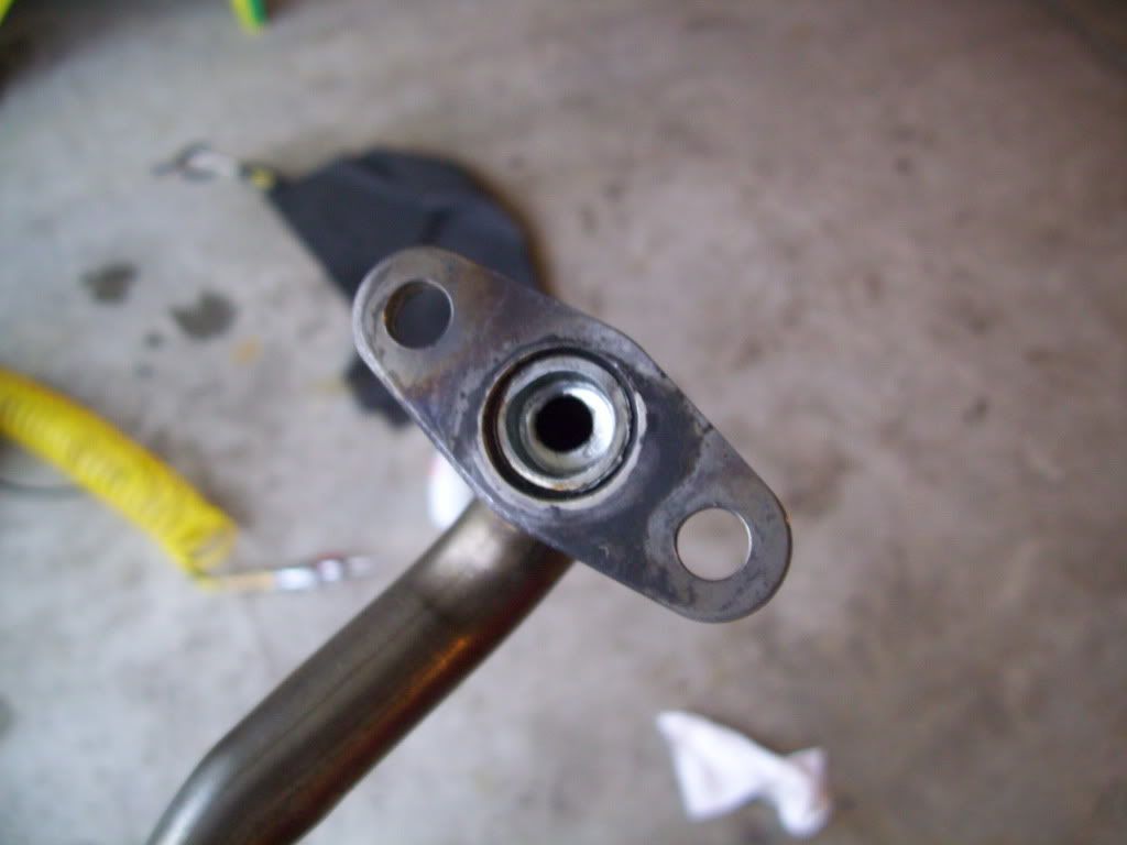

When I bought the PTP I/M spacer, they included a little press in bung(the same as their B/S delete plug, for reference), which I used to press into the actual EGR tube. You don't want to use a plate, if you plan on restricting the EGR, since the EGR tube will most likely not screw back into the I/M.
Here's a pic of my first pressed in bung:
As you can see, I drilled a pretty large hole, so I removed it. I later went to ace and picked up a bunch of bolt covers or things I could press into the tube. Once I got one to fit, I drilled a tiny(maybe 1/8" or smaller, I cannot remember) hole, and put the tube back in.
I'm gonna clean out the EGR valve soon, cause I'm sure there's a bit of backed up gunk in there, but after 10k, no CELs. The EGR still flows a tiny bit, which you can see from my clean I/M pic, with the tiny bit of soot coming from the EGR port. That's just what I wanted, a little bit of flow, but not enough to harm the clean air entering the I/M, and totally gunking up the I/M.
