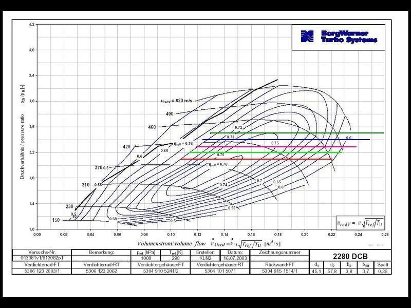

A strategy would be to actually lower boost in the upper gears

^ive actually wondered about that too...looking at where our turbo operates on the compressor map i think this turbo would run a lot more efficiently at a bit lower boost...slower sure...but safer...and with less lag
also curious lex about what you said about the stock boost controller...it runs out of room with flow mods? at what point can it not control the boost (after DP? after upgraded intercooler)...and is the only way to cure this with a new boost controller?
Retarded timing causes the flame front to happen "closer" to the exhaust stroke making the EGTs read higher - also causes the turbo to spool and that's why we have negative timing at the onset of boost.
also curious about that statement...how does the flame front occurring close to exhaust help with turbo spool? is it because the gasses will be moving faster due to having just detonated so close to leaving the cylinder?

^ic
i posted this in the k04 info sticky
not 100% sure...but when you do some calcs you find the operating range looks about right
this was done with the help of phate from m3f
these are the operating ranges for pressure ratios of 2.1, 2.2, 2.3, 2.4, and 2.5
i take the first green line going up from the bottom (2.2 PR with a boost of 17.64 (this is probably about what our turbo sees as im thinking we lose 2-3 psi in the intercooler)) as being our operating range which as you can see is right on the edge of choke....making anything much above stock a little dangerous as you get farther and farther into choke at earlier rpms (unless you upgrade intercooler and lower your boost loss)
again...i searched for this off google and the forums....is it exactly our k04? im not sure...but i figured it was fairly close
edit...i just found out and im almost 100% sure this is the map for the K04-2280 (K0422-881 & 882)

 Old 04-01-2010, 03:32 PM   #67
Captain
djuosnteisn's Avatar
Location: Rio Rancho, NM
Posts: 11,480   (View Stats)
Rep Power: 15759
Thanks: 33,656
Groans: 79
Yeah, i don't think it is ours I've seen that map before.
But your probably right, and it's probably close.

anyone know our exact k04 number?

 Old 04-01-2010, 03:39 PM   #69
^ This is why the boost drops in the higher RPMs. The turbo can't meet the air delivery requirements.
 Old 04-01-2010, 03:42 PM   #70
TRex's Avatar
Posts: 3,139   (View Stats)
TRex is the leader of the worldTRex is the leader of the worldTRex is the leader of the worldTRex is the leader of the worldTRex is the leader of the worldTRex is the leader of the worldTRex is the leader of the worldTRex is the leader of the worldTRex is the leader of the worldTRex is the leader of the worldTRex is the leader of the world
Thanks: 895
Thanked 3,629 Times in 1,381 Posts
Groaned at 106 Times in 69 Posts
^agreed we start to choke like crazy
makes me wonder why so many want to throw 19+ psi on it....it just falls flat on its face and puts a lot of stress on the little guy
TRex is offline   Reply With Quote
 Old 04-01-2010, 03:52 PM   #71
** This is quite off topic but I love an intelligent discussion **
You can throw 19psi at it at 4500RPM. Just don't be too aggressive with boost in the higher RPMs. I like 17-18psi in the midrange.
Shifting at 6k is probably optimal.
From Garrett:
The Choke Line is the right hand boundary of the compressor map. For Garrett maps, the choke line is typically defined by the point where the efficiency drops below 58%. In addition to the rapid drop of compressor efficiency past this point, the turbo speed will also be approaching or exceeding the allowable limit. If your actual or predicted operation is beyond this limit, a larger compressor is necessary.
◊ Turbo Speed Lines are lines of constant turbo speed. Turbo speed for points between these lines can be estimated by interpolation. As turbo speed increases, the pressure ratio increases and/or mass flow increases. As indicated above in the choke line description, the turbo speed lines are very close together at the far right edge of the map. Once a compressor is operating past the choke limit, turbo speed increases very quickly and a turbo over-speed condition is very likely.
◊ Efficiency Islands are concentric regions on the maps that represent the compressor efficiency at any point on the map. The smallest island near the center of the map is the highest or peak efficiency island. As the rings move out from there, the efficiency drops by the indicated amount until the surge and choke limits are reached.
