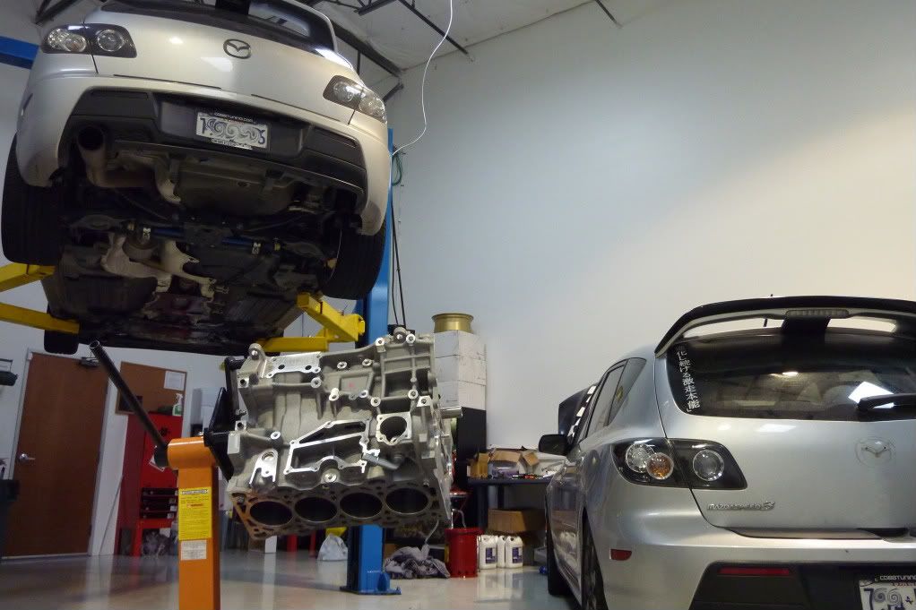

The damage to the gear was from the rod on it's way out the block. It looked fine back when I took the BS out, I have pics during the removal floating around somewhere. I wonder how much more impressive the carnage would be if the gear wasn't there to act as a shield.

So are you tearing this down for inspection or no?
For all of you whining about not making power - listen to 06speed6. If the head flow is as poor as he states (200CFM @ .500lift) and we have a mid .300 lift on stock cams you will not make any more power without head work.
Why such a curse. Because this is how the motor was designed. This is for several reasons. One of them is because with DI, airflow at low loads through the head is very important to achieve the higher economy than port injection. Higher torque at lower RPM is what exploits DI and Mazda used this and GM used this with their Cobalt. A lot of tumble and carefully designed high velocity intake ports do this. Low end torque is awesome but the top end drops like a rock.
There is no need for more fuel right now as fueling is homogeneous at high loads and there's tons of it - almost identical to port injection. Fuel injection timing would be nice to control though.
The difference between us and an EVO (4g63) is that they have 25% more flow on a 1st gen motor - let alone the ones with variable intake/exhaust. That means they can carry the torque and make hp high in the rev band at the expense of low end torque. Get some cams with a higher lift and you make even more. No one seems to even do cams on this car. One thing to be careful of is that DI (in stratified mode) may not like lumpy cams. The Evo motor was meant to perform at higher RPM. It was designed this way. Not the case with the Mazda. Either do lots of head work or get over it and live with the low end torque. Without headwork and cams anything bigger than a GT3071 is a waste. If you do head work it might make the DI system rough at low loads as like I said DI is very sensitive.
The only other alternative on a stock head is nitrous as it is sprayed in liquid form and the energy content is much higher per volume than air - therefore not being affected by the low flow as much.
Yup, that's the plan
Originally Posted by DCLXVI View Post
OP what was the reason you put the balance shaft back in? and why do you think it still would have happened without it there, as you say it acted as a sheild? looks like the rod blew right where the balance shaft was.
I didn't put it back in. That's just the drive gear for the balance shaft, which I never took out.
the intake manifold problem makes sense, that much more airflow to a certain cylinder can cause problems especially when boosting 1-3 psi and ur supposed to around 14.7 but instead that one cylinder is a lot higher because of the increases flow, which could explain everyones p-t blowup.
My AFR was actually in the low 12's when it blew. I changed my fuel tables long ago and had the AP displaying measured AFR at the time.

SLS, can you check the fuel injector in the cylinder that blew for plugging?
Sure thing. Don't know exactly when the tear-down will start tho. It's a pretty pitiful sight in Cobb's shop right now seeing my car and the car who's motor build I was going to go check out. At least it makes for some decent pictures.
Mine on the lift. That's his new block, wish it was mine.
