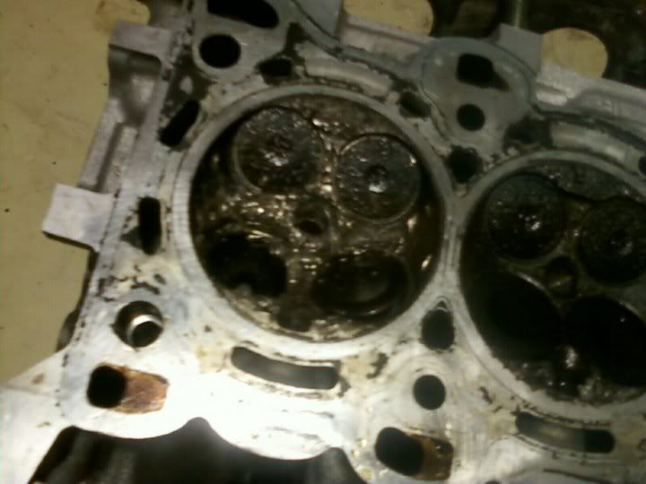

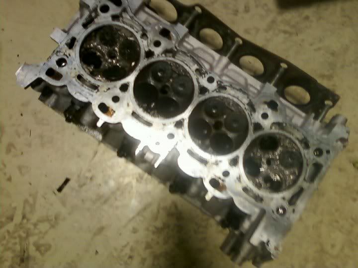

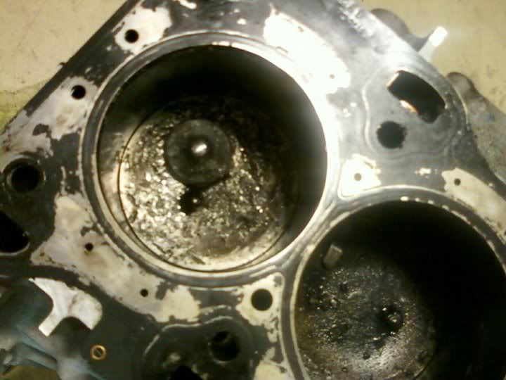

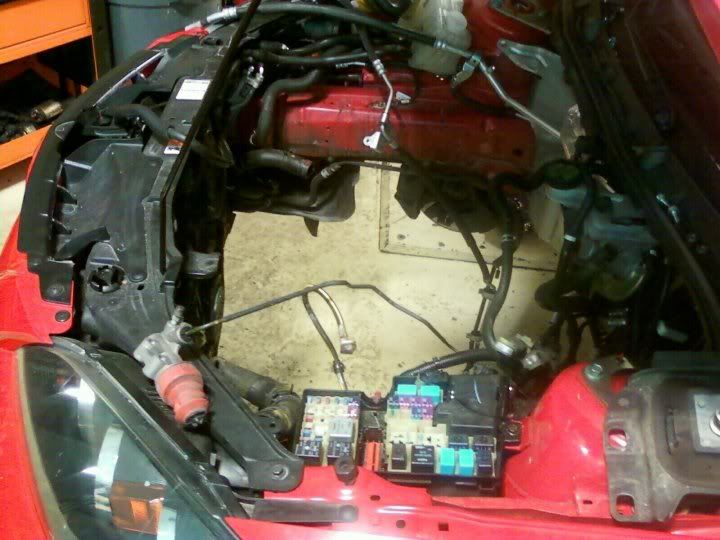

Mazdaspeedgirl 04-03-2010 11:47 PM
Here are the pics I took of the car/damage:
http://i180.photobucket.com/albums/x...orinstall1.jpg
http://i180.photobucket.com/albums/x...orinstall2.jpg
http://i180.photobucket.com/albums/x...a/newmotor.jpg
http://i180.photobucket.com/albums/x...Ra/oldhead.jpg
http://i180.photobucket.com/albums/x...eadpiston1.jpg
http://i180.photobucket.com/albums/x...eadpiston4.jpg
http://i180.photobucket.com/albums/x...torpiston1.jpg
http://i180.photobucket.com/albums/x...torpiston4.jpg
http://i180.photobucket.com/albums/x...a/newturbo.jpg
http://i180.photobucket.com/albums/x...ndnewturbo.jpg
It was actually TWO cylinders that had the valves break. o.O
Lex 04-03-2010 11:50 PM
Nice pics. So ummm ... did those valves drop or wtf happened? It seems as though something got banged around in cylinders 1 and 4.
Mazdaspeedgirl 04-03-2010 11:52 PM
lolz yes. The valve heads.
Lex 04-03-2010 11:54 PM
I've seen a few blow-ups but haven't seen something like this. Valves sheared on 2 cylinders?? It's really not adding up - so what's missing from this story morning glory?

Prolly had a bunch of detontaion in it's life cuz it gets mad hot here. We have 100 oct which is what the car needs here, but i wouldnt be suprized if the owner blatantly put 87 in a few times druing the high gas price era. I always use a blend of 91 and 100 during the summers here.
Speedee3 04-04-2010 02:38 AM
Holy crap, that looks worse than I would have thought!? Valve imprints everywhere!
Ken
Frequentflyer 04-04-2010 10:15 AM
Holy shit. Looks like your timing chain snapped, but I can't imagine that's what happened since I've never seen a chain snap before. Belts yes. This is also the first MS3 motor I've seen where the valves imprinted themselves on the tops of the pistons to that extent. There's something different about this blown motor for sure! Doesn't look like any rods exited the side of the block either, which usually happens. Do you know for sure if the timing chain was in one piece when they disassembled?

Valves hitting the piston can happen with the timing chain still intact. Look here. Local in Vegas. Post 78

Since 1 and 4 come up together it's likely it jumped timing.
darth vader 04-04-2010 05:03 PM
If it jumped timing then, when the other 2 came up it next bang would likely have trashed them, too. Motors won't stop dead when catastrophe like this happens, usually there's enough momentum to carry it around a few times and fuck everything up.
Nothing. I'm sure you WANT to blame me, but i was just driving home from work. It was very uneventful: merging onto the highway, about 5k, hesitates, CEL flashing, then *pOOf* dies. *shrugs*

^ I don't want to blame you at all. I think the motor had an issue, and I think it's timing related. Piston hit valves, broke them, then they bounced around the combustion chamber for a little while.
ToledoSpeed3 04-04-2010 09:57 PM
Yikes! These pictures should be examples shown in the automotive dictionary under "Interference Engine".

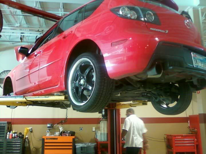

lol... well it's all back together and I picked it up this evening. No matter though... the motor was not a rebuild, so there wasn't a way to have them put forged internals in anyways. It was a complete long block from the factory, with new drive train warranty. :)
On another note, North Park Mazda did well on this catastrophe. They even fixed my radio to where the media button works again... free! They have my loyalty for sure now. :)
