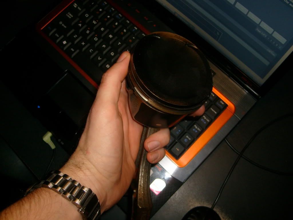

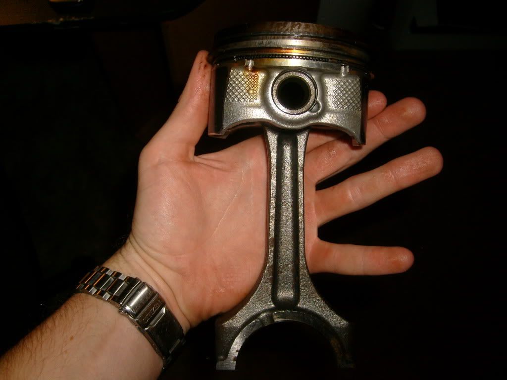

 Old 11-20-2009, 12:41 PM   #90
Here are the pictures:
Stock rods needed for testing
bani (12-06-2009), glocK23 (11-20-2009)

Originally Posted by glocK23 View Post
AFCadet, Show this man proof before he goes to your place of home and steal your unborn babies.
Seriously...............
I would have no reason to steal his unborn babies, just looking for something other than his explaination of it failing. The other odd thing, out of no where he came up with this being the reason. He has a thread talking about WI and running the car lean, then his motor goes boom (if you read the other thread several told him to not lean the car out with the WI). I would like to see the proof before I start making my own "stories" as to why his motor blew, but could it be possible that it blew because he ran out of fluid in the bottle? How about it bew because the rods are MFG wrong like Lex has stated in another thread? Or better yet, if you look at his first post he was not even WOT when the motor popped, could it be the dreaded bent rod, blown motor hydrolock that I talk about in here: http://www.mazdaspeedforums.org/foru...-inside-16710/. We said 6 months ago that Mazda knew about this issue, we knew about connecting rod issues at that time as well... but never put any thought into it due to the pins showing even wear on both sides of it. If it was in fact out WI point, you would see 100's more with blown motors running our WI spray point, that just isn't the case and stating otherwise with no proof to back up your claims is silly.
I see 1 and 4, where are 2 and 3? All of them side by side would be a better compairison, but since you have several pistons and rods, I would have to ask how I could trust you to give an accurate account for what was in his motor and what wasn't.

Out of the 3 rods/pistons I have, one is obviously snapped in half after seemingly being bent for a while. This is #1.
Another one has a bent rod and shows irregular wear on the piston skirt showing it was bent for a little while. The piston top is well carbonized. From the above description I assume this is piston/rod #3.
The last piston/rod is not bent at all. The piston top is very clean compared to the other piston/rod that was slightly bent.
AFCadet, where is the last piston/rod from the engine?

I currently have it...the rod is straight...no bends...and it had the cleanest piston head out of all of them. So it was cleaner then the one you had. I could take a pic if you like.

Heres the last piston/rod. I know for a fact this came out of cylinder 2 because it was the first one to pop out and everyone was like...holy shit that piston is clean for having 40,000 miles.
