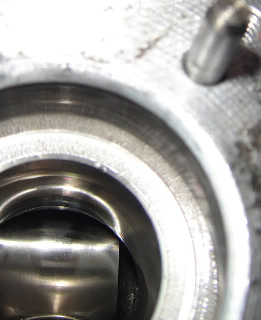

Ok , anyway i will post my cam lob picture tomorrow because i will put back in my stock pump with a brand new cam follower so will see if the rattle will be there .

blackwidow 11-06-2010 05:34 PM
Ok , fuel pump has been removed and the cam is # 1 , new cam follower has been installed and the first one was normal IMO but i put a new one , result same rattle , i have installed my stock valve on the top of the fuel pump but still same rattle , the CP-E spring is #1 , no loose parts , samething with the stock pump so now i really don't know what it could be .
Here my cam lobe picture link , sorry for the poor quality but the cam is # 1 . I have 38000 KM on my car .
cam follower picture by blackwidowms6 - Photobucket
Lex 11-06-2010 05:37 PM
So the stock pump rattles the same?
Also, I can't tell but how is the wear on the cam lobe?

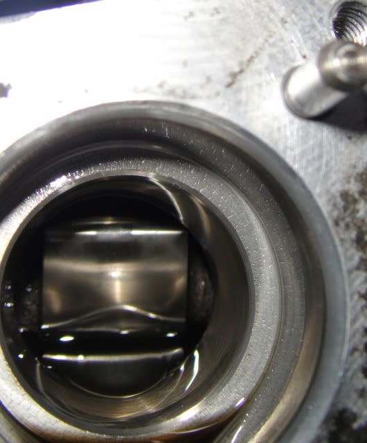

blackwidow 11-06-2010 05:39 PM
The wear on the cam lob is normal no sign of extra wear . Here another picture .
cam # 2 picture by blackwidowms6 - Photobucket

blackwidow 11-06-2010 05:48 PM
CP-E pump has been installed June 2009 . So maybe 8000km . I don't have installed the complete stock pump , just installed the valve on the top of the pump , reason i had some another mecanic jod to do so we were tired , long day on the car for new PCV valve install ( need to remove the intake manifold) and rear frame brace install + adjustment on my rear coilovers (height) , so will install the complete stock pump next time . But the CP-E pump has no loose parts and no sign of wear on the spring . Sorry for my language , i'm french .

blackwidow 11-11-2010 04:53 PM
Huge update guys in my case , New stock pump has been installed and remeber i have a new Cam follower and my cam lobe is in great shape , the bad news is the rattle is still there so i reinstalled the CP-E pump , rattle still there again , fuel pressure is always good with both pumps , my Mazda tech unplug the boost solenoid and WOW no more rattle :yeah: , so my problem is my boost solenoid . I will replace it next monday . So guys try your car with the boost solenoid unplugged and let me know .
