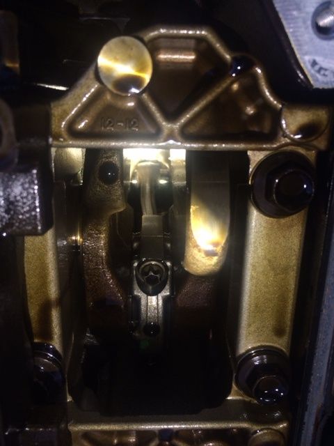

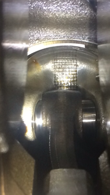

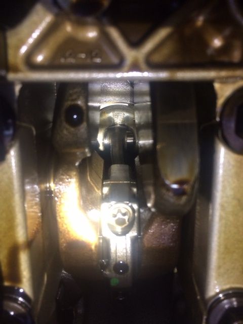

Well, was driving home about 2 weeks ago; turned onto my street and nailed it in second, shifted to third when the car loaded up and backfired HARD. I let off the gas and hear a strong knock and the dreaded vibration in my clutch pedal. At this point I know this isn't good, I drove her the rest of the way home (about a mile). Turned the car off and had it towed to my Dads house as he has a garage since I live in a condo.
At first the knock had me thinking that I had spun a rod bearing, so today I pull the oil filter and check for shavings; nothing. I then run a magnet through the oil I drained; nothing. Feeling anxious I then pull the oil pan to see if anything is chilling in the bottom of the oil pan; nothing. Well shit, let me check the rods for bends; voila! As you can see in the pics below cylinder #4 rod is definitely bent, the others looked fine from what I could see.
Question for you guys, could the rod being so uncentered on the wrist pin cause the knock I was hearing?
Either way I will be pulling the motor soon and having Precision Crankshaft do the machining and full assembly of the motor.

I'm not sure, but I assume that "the rod being so uncentered on the wrist pin cause the knock I was hearing?" was caused by the rod bending, not the reverse. The knock could be it moving around now though.
