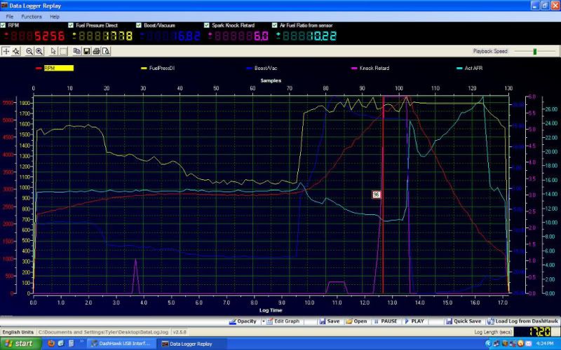

This is what I am having issues with...REALLY high knock retard in 3rd+ gear when all other things seem to be OK. Running Shell 93 gas, and BATs are always in the mid to low 90s with the water/meth.
http://img.photobucket.com/albums/v7.../Log7-2-10.jpg
Any ideas?
Mods: CAI, turbo inlet, FMIC, catless DP, Forge BPV, Cobb AP
I am currently running stock heat range plugs, but I was actually having more of an issue when I was running the step-colder plugs.

Did it just start? I was just talking to cpolly about a similar KR problem. He had a bad tank of gas and added octane booster and it went away.

When you were running the colder plugs, did you gap them to .026?
At 6degrees KR you should gear some audible knock happening. Did you hear anything?
AntiStock 07-02-2010 03:39 PM
Nope, not hearing anything...and I had the plugs gapped to 0.028"

I'm used to my KR being blue.. I saw 26.0 and start laughing my ass off.
