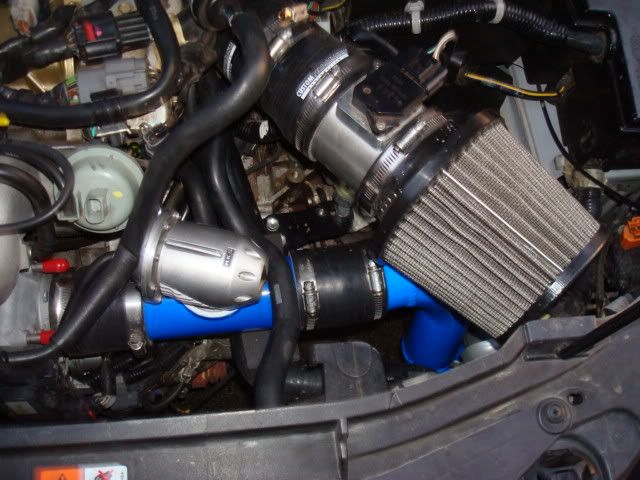

EdgeAutosport.com 03-16-2012 09:58 AM
Nothing wrong with a little vta :)
http://i1059.photobucket.com/albums/...9/DSC00999.jpg
shawn. 03-16-2012 10:03 AM
no real problems with vta if you adjust your tune. running recirc is just easier...
EdgeAutosport.com 03-16-2012 10:08 AM
Yeah I get some part throttle quirks running vta but nothing that cant be avoided :yup:
