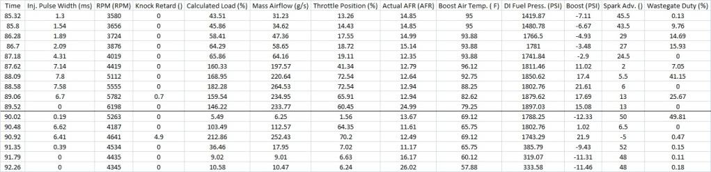

The stock MAP sensor caps out at 24psi. So it's likely you were actually spiking higher than that.
didn't even think about that, but you're probably right... just wish I knew what caused the over boosting...
also, for those that say the new ko4 shouldnt have been boosting any diff...well.... let me tell u this, i boosted 2 psi higher using the new ko4 with the ported hotside and THE SAME WGA from my oem ko4....
so...anything is possible, the lesson to be learned is to NEVER get on it until u know the car wont overboost, i have spent the past 2 days trying lil by lil with my set up to see how the car reacts with roll in throttle , stabbing at throttle, diff rpms etc etc...

^ this all sounds awful. The cutting could have very well been deto, and seems like a healthy dose. Your lucky to have a complete block man, congrats on that! And now you have an excuse to make your block much much stronger.

.... The cutting could have very well been deto, and seems like a healthy dose. ......
Yep, this ^^^^ is what killed the rod(s). Been there, done that. I was driving codemaster883s car when it happened on stock turbo with AP OTS map and no standalone boost gauge.

This is also a lesson about setting safety thresholds on a stock block. If the ECU cut limit is set at 3.0 load ... well it's too little too late.

LOL Have you seen my Load tables? They're indeed set to 2.95. I use the max boost fuel cut to "save" the motor (it works well BTW), well at least up till now! I really don't WANT to vent the block, but you gotta break a few eggs to make an omelet! Wish me luck, PLEASE!
This brings up an interesting question. When I have set any limit tables like Throttle Close or Fuel cut on the Boost tables I notice that just because you hit those limits doesn't mean the ECU will enforce them, at least not immediately.
Maybe you have to exceed that limit for a full second or two? if that's the case it would likely be too late.
Has anyone else experienced this?

Best safety net is a properly setup knock sensor and KR IMO. Cuts are helpful, but you can definitely detonate below cut thresholds in many cases, and many times the cut has to be "qualified", like exceeded for XXX milliseconds... which is often too late.

I have been traveling most of the last 2 weeks and am just now reading through this thread...
My best guess is that the boost went well over 24 PSI causing detonation or simply too much cylinder pressure (either = FAIL for the stock rods).
Which map were you on when said FAIL occurred? I will look at if for some clues.
It is a shame we don't have more logs to examine to better understand the exact failure mode. The single log you had from the boost targeting map appeared to be in early gears (2nd/3rd maybe) where there were very few data points to make any meaningful determination other than the WGDC was chasing it's tail wildly.

If it was just the second map, the key attributes on it where as follows:
  • Boost targeting, aiming for 17 PSI (intent was to be super conservative until how the car responded was understood/dialed in)
  • WGDC was pulled down 1-3 units (~5-15%) across the board from the HE16c map
  • Boost Dynamics were about 20% detuned from what was working well for me with my K04 in boost targeting mode
  • Used the same boost limit - fuel cut as in HE16c (22.6 PSI). In hind sight, this probably should have been lowered to minimize the chance of overboost prior to cut.
Here is the single log from HE18:
I am assuming this is a 2nd/3rd gear pull. It is obvious that the WGDC is pretty much going bonkers and that he was running a full point leaner than on the previous maps prior to the turbo swap.
HE19 was going to cut the boost dynamics in half and drop the boost limit - fuel cut to 22 PSI, alas it was too late by then.

I sent you two HE18's within a few min (made another quick tweak on the second version), is the second one what you call HE18b or did you make changes to one of them to arrive at that map?
whats the deal with that super high load at 4500 rpm?? KR went nuts too.
man this shit kinda makes me have second thoughts about letting xtian tune me with ebc
I'll let Cld12pk chime in here... That was the first map we tried that was boost based instead of load based...
ya idk shit..it just looks odd compared to other ones ... so u seel any shit yet?

Originally Posted by AtTheDriveIn View Post
Sorry to hear. I'm glad you got another motor so you're not in a terrible situation, but there's always the cost/time of building and swapping involved. Hey if you decide to get rid of the Volks shoot me a PM...
Pm sent about wheels...
Boost was spiking after the shift. Since the KR was in the last data row prior to lifting, it is unclear if that is "let of throttle KR" or the more typical kind.
We really just don't have enough data, but everything tends to suggest that the new turbo/WGA was responding much more aggressively than the previous setup.
What is confusing is why the pull showed lean in the first gear during the pull. I wonder if the meth was not working or if we had unmetered air entering between the turbo and MAF?
Lenny,
What I would recommend when trying out new maps or after hardware changes would be the following procedure:
1.) do a partial throttle pull in a high gear (like 4th or 5th) to above the CL/OL transition (say 10 PSI) and log while watching AFR or KR on the AP. Review datalog to assure that your AFR is as per your fueling tables in OL else you need to fix something (recalibrate MAF tables, get meth working, fix unmetered air leaks). Also verify that nothing unexpected is occurring with the boost control/WGDC or KR.
2.) Once satisfied with the results, do other logs in a high gear to progressively higher boost levels until you have reached WOT analyzing the data after each pass (probably another 2-3 iterations).
The reason I say do it in a high gear is that bad things can happen way too fast in the low gears to respond in time and in our case we cannot get sufficient data in any gear below 4th. If anything is amiss on the above pulls, lift immediately and analyze the logs for clues as to what is wrong.
