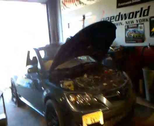

26-27psi seems to be the crank case pressure threshold for our cars.
To witness the dipstick dance watch this short clip of Doubleflusher's car (27th sec)
This is what I did to help alleviate more crank pressure under boost.
Tapped 4 holes 1/4" dia. to the baffle plate inside the valve cover. This helps venting the crank pressure out the valve cover breather under serious boost. The downside is you still blow out some oil. For this I run a catch can at the valve cover with an air breather on the outlet side. I've ran 30psi with no dipstick issues like this.
I also removed the stock pcv and ported it to the point where it was basically a 90 fitting to hook up a hose to. When we started the motor for the first time, I had the exact same issues Bluestreak mentioned above. We could of adjusting the maf to allow the pcv, I'm just not sure if its even worth doing all that. I went back to a new stock pcv>cv>occ>im.
Dano clean that valve up, find a way to vent more crank pressure if you wana play above 27psi.
Go back a week later and check the valve again, if the issue is still there you will know the valve guide is leaking.
